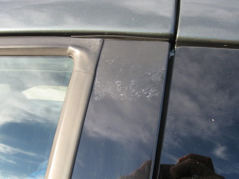

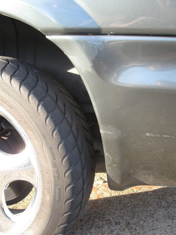

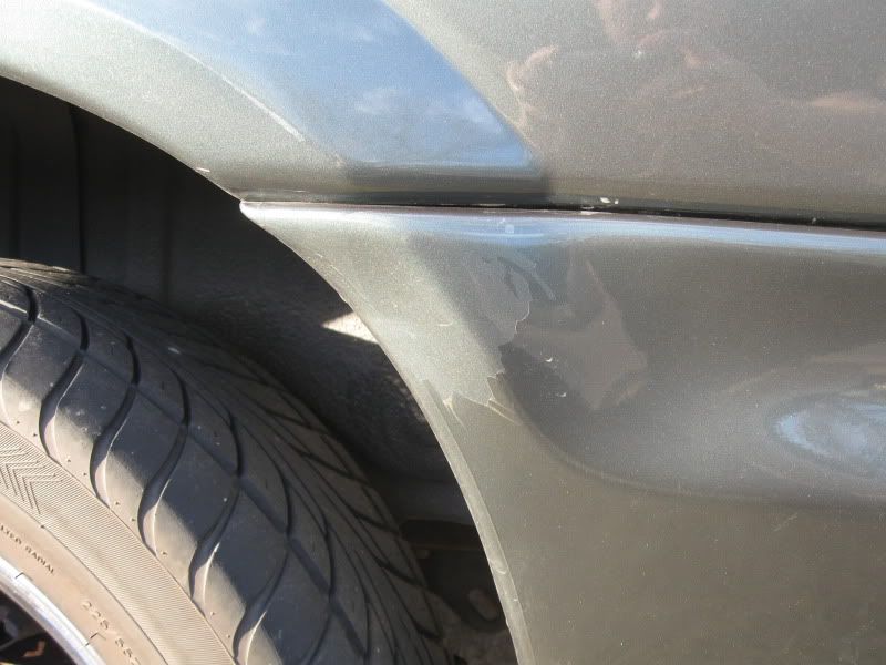

oh noes....went out to recheck everything on the van (the wife just ran it thru carspa, again, lol)
Saw this:
On the rear quarter panel.
Looks like the clear coat is coming off.
can I still do the 105/205 over this? or will it rip the rest of the clear off?
Also, similar damage on the pilars on the doors, at the top:
I know I am going to have to get this re-cleared, but cant afford that for a while...i dont want to make it worse though......
Both melissa809 and citizen acane hit the nail on the head. Just let your wife run the van thru a tunnel wash and leave it go at that. At least it will be clean.
Focus2069- My '93 Audi has areas of clearcoat failure and peeling paint. I went over them *very* gently with the same products I used on the rest of the car. Note that this this ended up making the messed up areas a bit larger as some of the paint was ready to flake off anyhow. After the damaged area got a bit larger, I got to the point where the paint was still adhering OK, so it's not like the areas got *HUGE* or anything. The compounding/polishing smoothed over the edges of the cc failure and, IMO, made them less likely to keep chipping/peeling/etc. back farther. I then LSPed these areas heavily and tried to be gentle with them.
It's been quite a while since I did that (did it for the original owner and subsequently bought the car from her) and the damage hasn't spread. Not at all.
