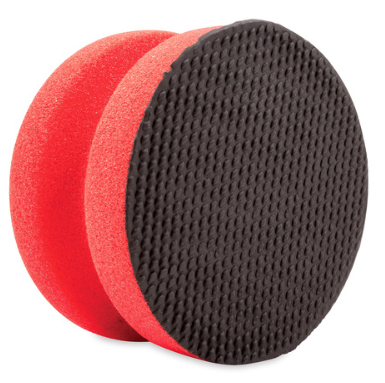

I have been a fan of traditional clay.
The new Optimum Clay towel has shifted my thoughts tho. It is by far my favorite clay towel on the market.
I used a mitt today on my single stage white 96 Miata. The mitt did a good job at removing a winters worth of embedded dirt and was white when I was finished. Washed it off and it`s good to go. I think real clay would be trashed using it on single stage paint.
