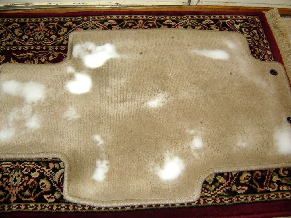

I washed the matts first. These are some before and during pictures.
And these are the afters when I was drying them outside.

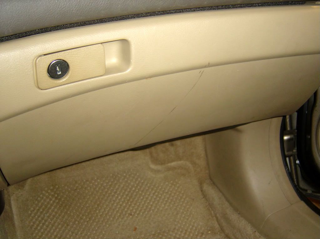

These are the interior before pictures. It was pretty filthy, especially when I took out the seats. Oh, and thanks guys for telling me how to deal with the wiring under the seats. Couldn't have done it without you guys.

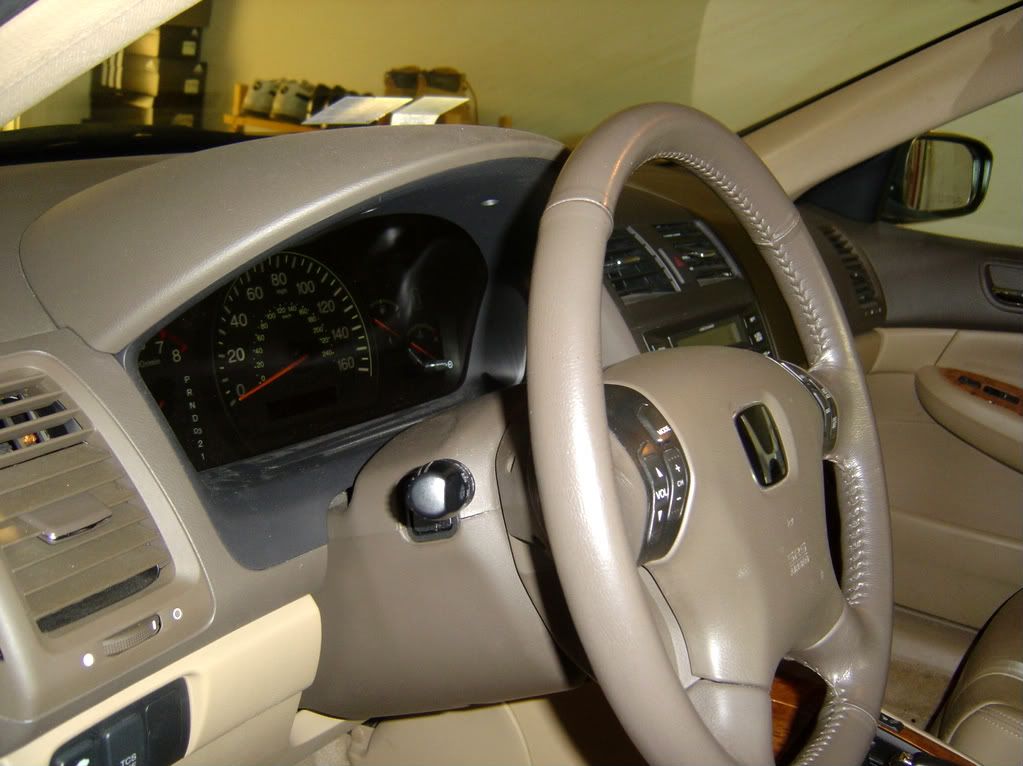

And here are the afters. It isn't real good because I only used distilled water to wipe down the dash.

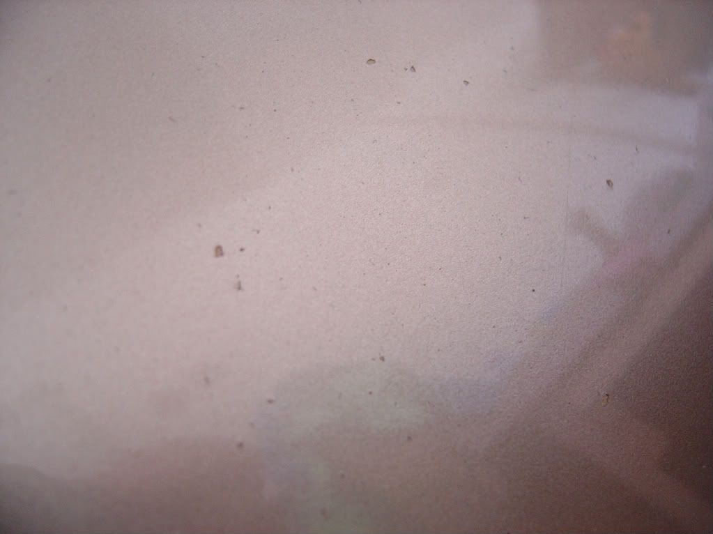

These are the befores of the car. I really don't know how to capture swirls. Maybe it's my camera but I can see the swirls myself but when I take a picture, it doesn't show up. But anyways, there were a lot of swirls because this car has never been detailed.

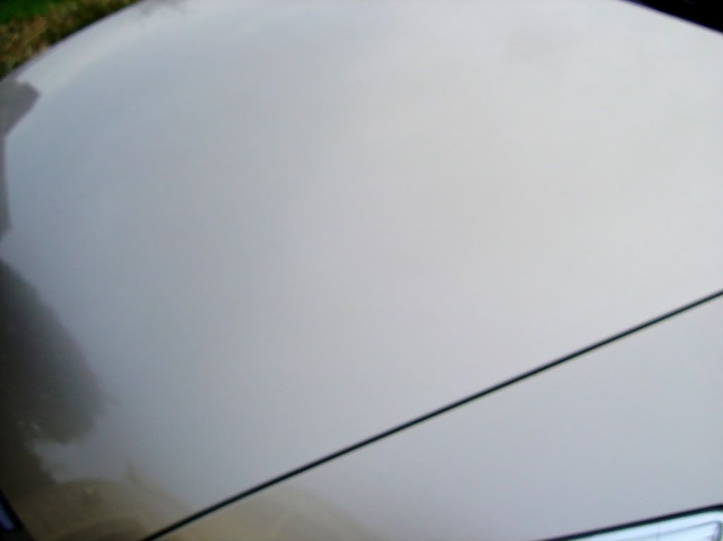

This is after I polished the right side of the hood. I was kind of disappointed because there wasn't a huge difference but I guess I have to learn how to use the UDM a little more before it will be better. Maybe it doesn't look different because it's gold and not black? I don't know...:sadpace:

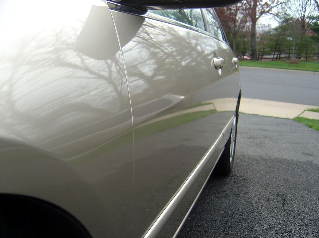

And these are the afters. I couldn't get good pictures because the sun was down already but I did what I could.
