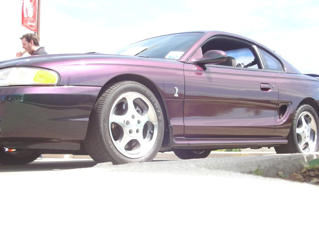

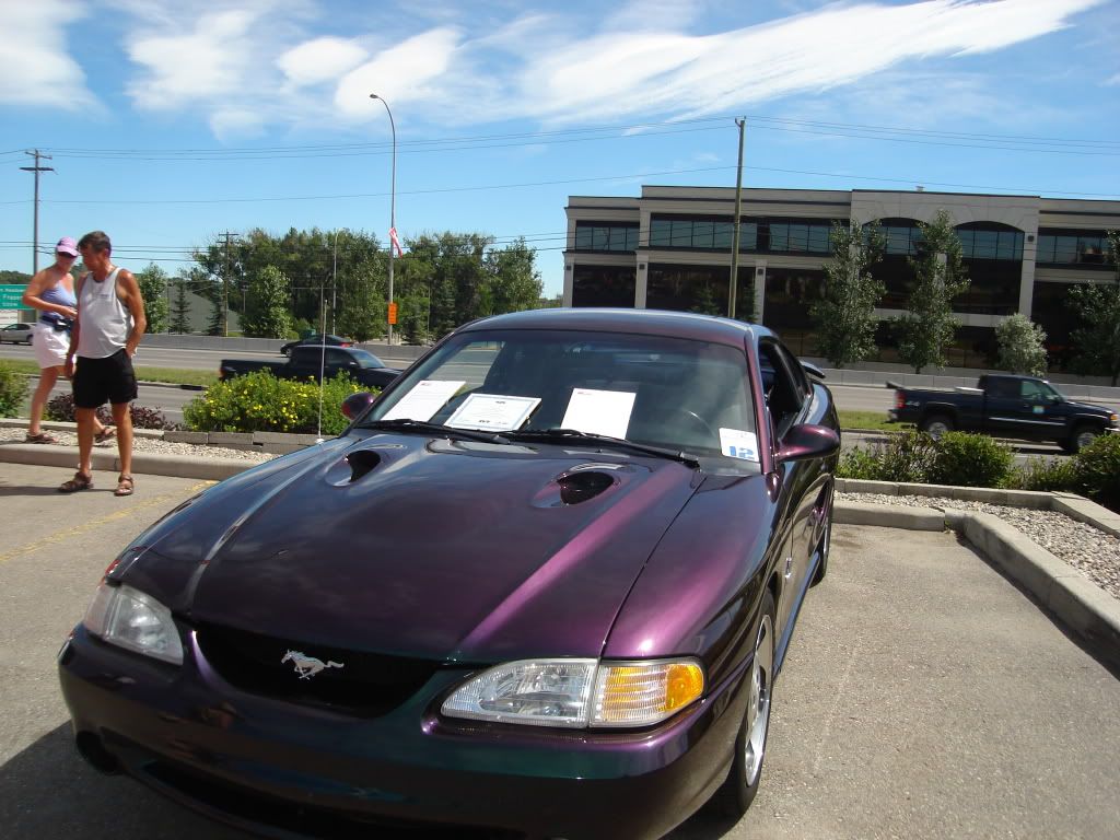

heres a pic of the dull looking car on the bright sunny day!
heres a bad pic showing the "pop" i speak of...
what im talking about is a bit hard to understand unless you've seen this paint in person, it really dosent take well to photo's :/

joker, being that you own a mystic aswell, do you know of this "dull" state that i speak of? where the paint just looks green or purple? or should i maybe put all that down to lighting conditions?
