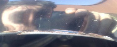

Here's a picture of a spot on one of the fenders that I want to airbrush. Both fenders have spots similar to this, but this is the worst spot.
As you can see there is some surface rust. I already sanded a little bit off, it doesn't go down deep at all. If nothing else i want to hurry up and do this to keep it from seriously rusting and turning into a bigger headache.

As far as your chips/scratches go I'd at least try to get the rust cleaned off and some primer put on them until you get around to actually touching them up. Griots has a small spot sanding tool that works pretty well for small jobs like this. Here is a link:
