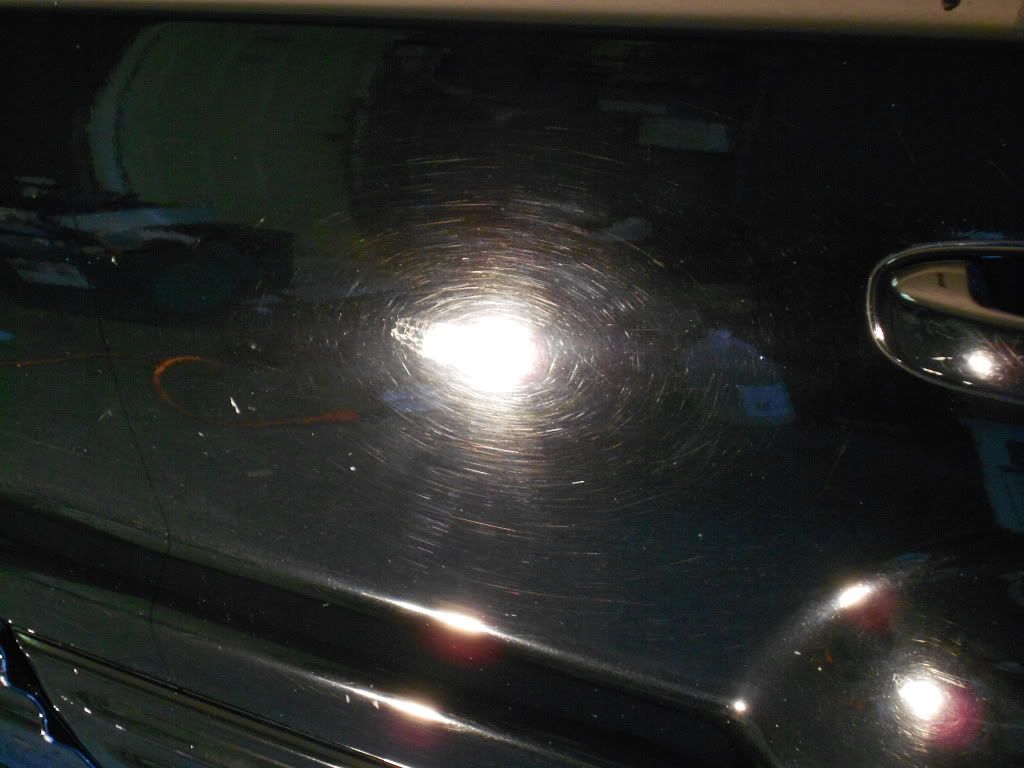

I know what your thinking, not too bad for 160k miles. Cover your eyes: Here is after decontamination wash, and claying under the halogens
Even the flash on my camera captured swirls

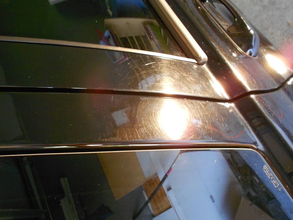

Pillars swirled
