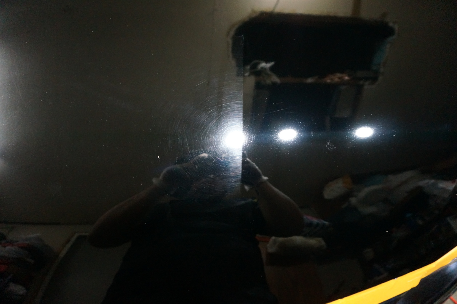

2010 Jaguar FX paint was hammered with Rids, Swirls and deep scratches...
Hard to beat this combination, even on super soft paint, after several test this combination provided the end results that I was looking for.....
Meg's 101 Foam Cut Compound with LC White CCS Pad, followed by LC Green with Menzerna PF2500 then Jewled the Paint with LC Gold Compressor Pad and Menzerna SF4500

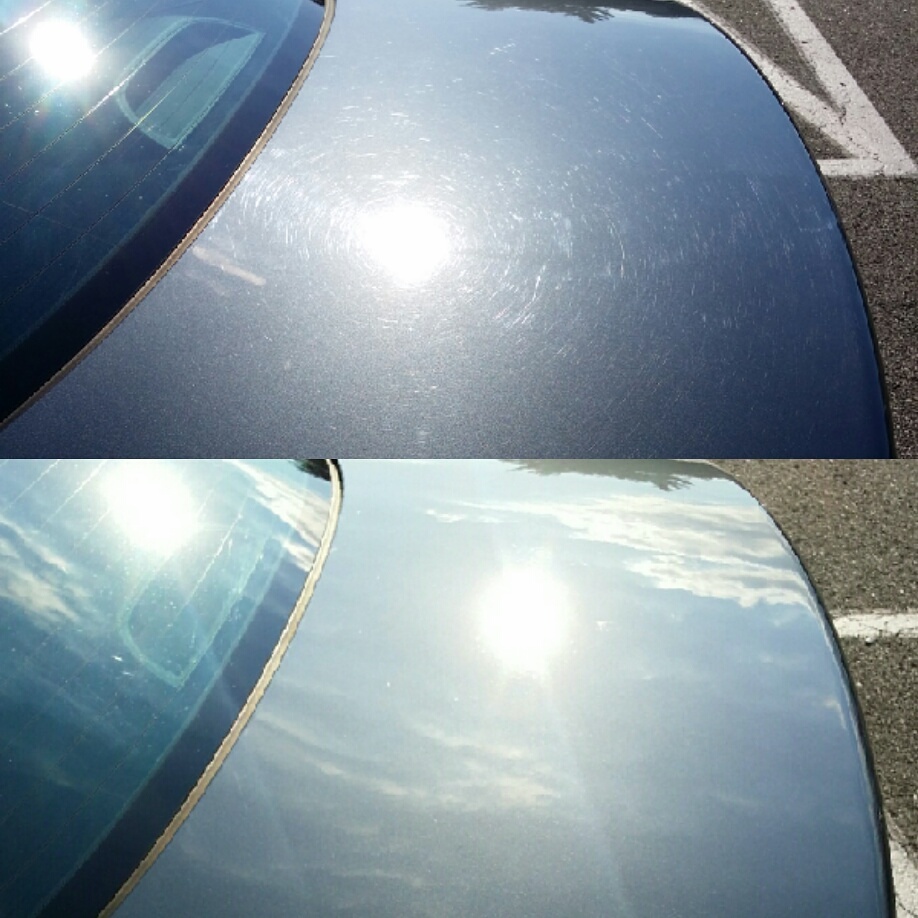

Megs 105 and 205. Wife's 06 Uplander after a full paint correction. 105 with my rotary and wool pad. Finished with 205 on a 3m grey waffle pad on the rotary.

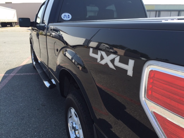

It's on the conservative side of two steps but I've used PF2500 with an orange pad(lake country) and then went to SF4500 with a white pad

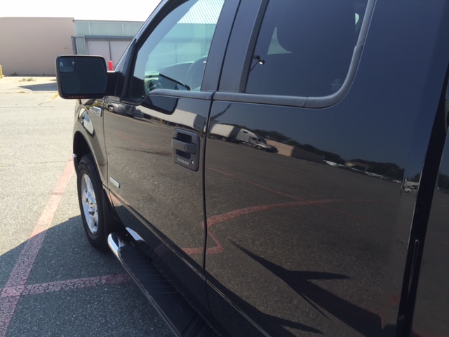

Touch ups one step on the front hood here with SF4500
One step PF2500 on a white lake country pad
My more aggressive two step dance would be FG400 and now SF4000. ...maybe SF4500

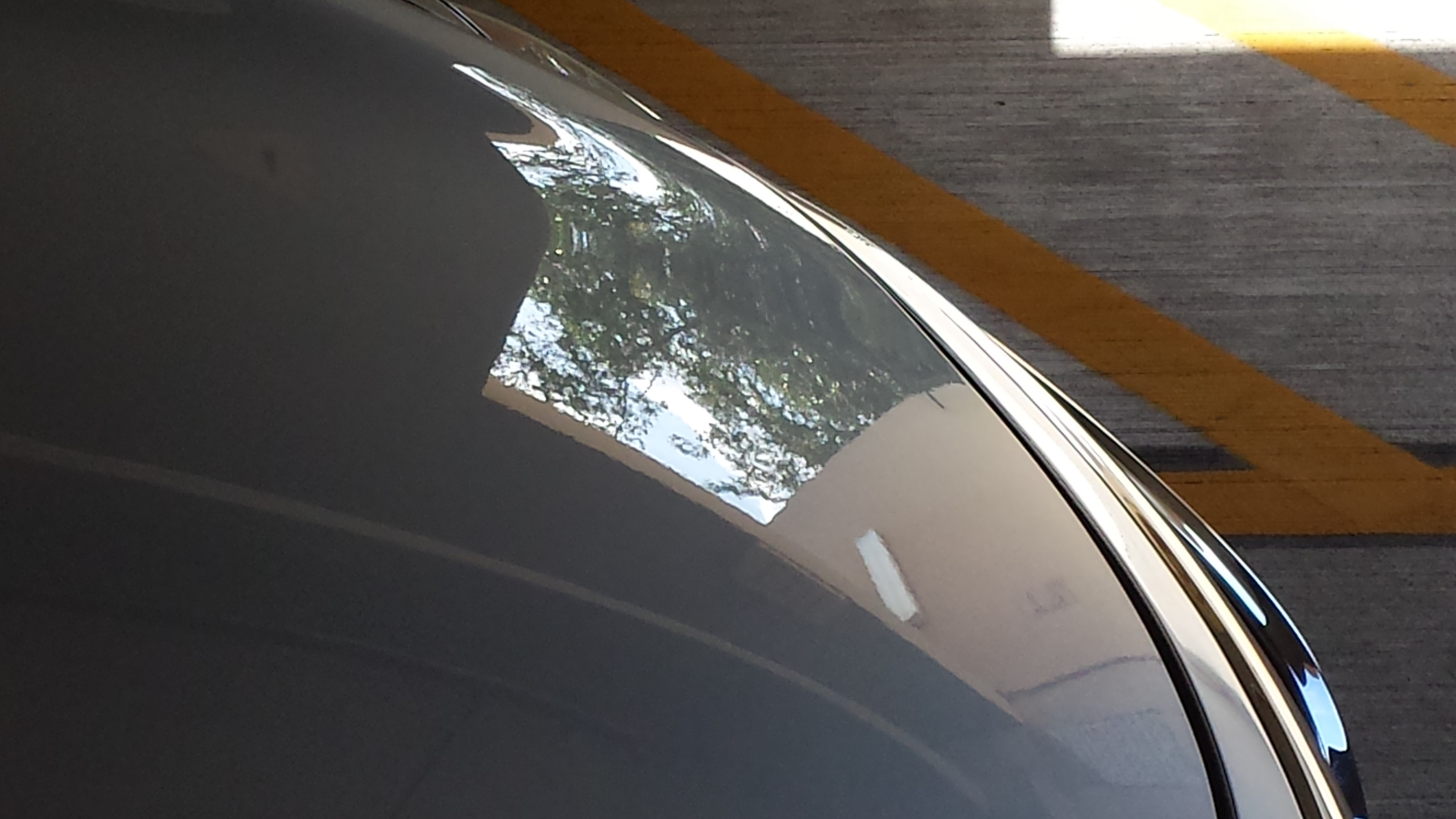

Rod, I've used PP2 with an orange pad a few times. But for a vehicle that doesn't need much correction I tried this on my Edge after detail weekend.

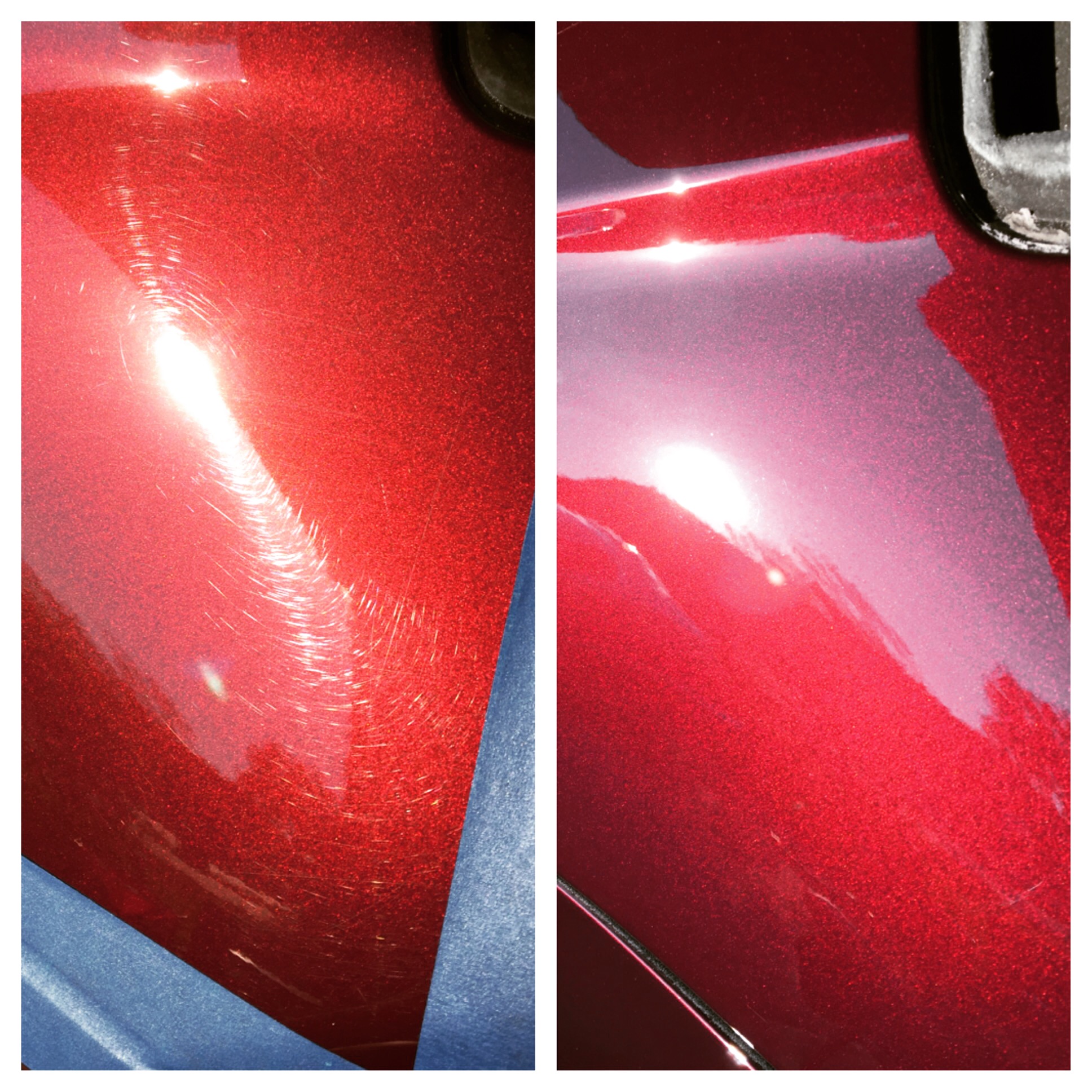

Not a pro like some of you guys. I'm just getting started. I used Wolfgang Concours Series Uber Compound and total swirl remover. This site is a wealth of knowledge for the beginner and veteran. I've learned a ton. I'd like to try some other products. Good luck to everyone.
