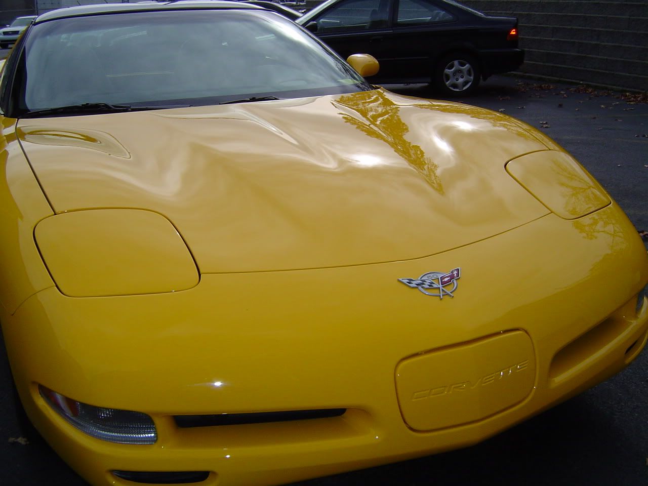

This car was in very good shape to begin with. Interior was just a little dusty and exterior had a few minor swirls in the paint and wax was caked in all the cracks & crevices which wasn't fun getting out. All in all it was a very simple process.
Washed exterior, cleaned wheels, tires & engine compartment
Polished complete exterior with Optimum polish by rotary with white polishing pad
Zaino Z2 pro x2 by hand
Sealed wheels with AIO
Dressed tires with Kar Kraft Super Blue Dressing
Interior Detail
Now to the pics:

Did you do an IPA wipedown for Z2 Pro? Did you ZFX the Zaino?

Sean- I did wipe the car down with a water/alcohol mixture before applying the Zaino to remove any oils & residue from polishing. Not sure if I need to or not but I guess it doesn't hurt.
Rick: As per Sal Zaino's reccomendations, it is imperative to wipe the car down with a 50/50 IPA mix to remove any oils from polishing unless you use Z-PC.
Even polishes like OCP and Menzerna have lubricating oils (not fillers) and will remain on the surface after polishing. A quick wipedown is necessary, according to Sal, to make Z2 Pro/Z5 bond correctly.
