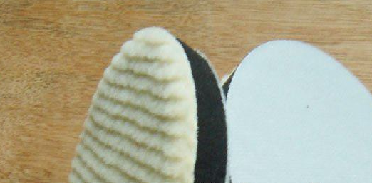

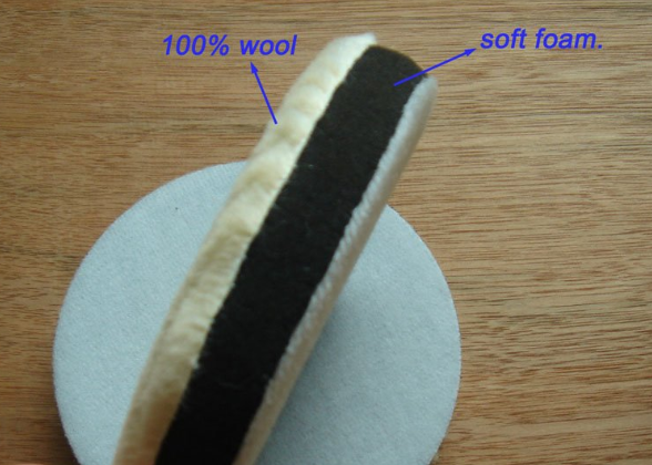

I wonder how they work? I also wonder if anyone has actually seen them yet?:cool:
Lots of companies are getting creative since the MF pads have come out. Now we're just revisiting a new way to put wool on a pad... Nonetheless, I'm interested!
Barry, I've been using this type of wool pad for awhile now. The ones I've been using have a very aggresive cut, however they marr like a *****

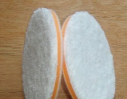

Yeah here is a new Microfiber thats not out yet. lol But I'm just curious about the wool. :2thumbs:
Those look a lot like one of the early/pre-release versions of the Optimum cutting pad.
The wool pad has me thinking of those velvet/denim pads SVR always talks about.

These look like they could work nicely for some down & dirt corrections!! Send me some!!!!

These look similar to what OPT was testing a while back:
Man, that's got defect killer written all over it. I'm thinking it would save a lot of time on those jobs where you have water etching and scratches too.

I have the excact microfiber pads and a bunch of new wool pads that are very similar to the ones in your first picture.
My wool pads are 5" and the wool length is 8 mm or - for you americans - ~1/3". Nice handling and cutting. I also have a wool pad who is similar to Carpros newest wool cutting pad 7". A great pad. I'll get some photos when I come home.

The electrified sheepskin pads work great on a rotary polisher or on a forced rotation dual action. I think they'd cut faster than microfiber because the it's my experience that polishes generally cut faster when used with wool than with synthetic or microfiber.
The shorter nap would work better on the random orbital because the nap looses some of its action against the paint as the backing plate changes direction and the fibers stay in place till the tension between the attachment on the pad and the paint is re-established and they start getting pulled across the paint again. It's like a brush against a carpet, if you just move the brush back and forth a little, the bristles stay in place. As you know, I'm not a fan of random orbitals because I don't believe they get much done, but since they have a following around here, I'm just saying.
If someone wants to make a foam interface pad to put on a dual action machine between the backing plate and short nap wool pads to help the pad conform more easily to the curves, I know I'd by a few.
