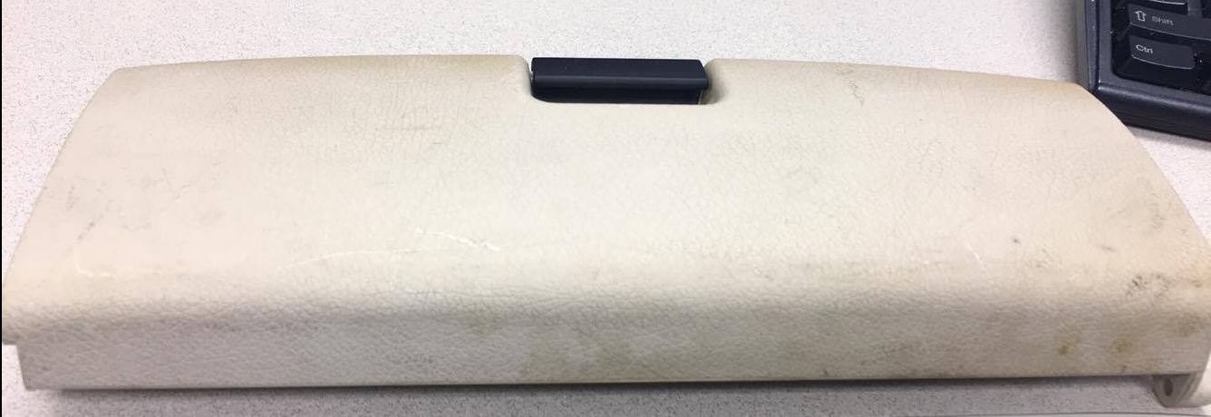

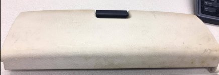

Good morning, looking for some advise in regrads of ways to clean and restore my car`s tan vinyl/plastic that is fading out. Since it is a very clear color it gets dirty easily. Any advice will be appreciate.

use a very mild APC and a coarse cotton towel ... use a very soft nylon interior brush if needed ..
I am not positive but if you tried to buy a replacement it would come in black and have to be painted, so under that beige could be black .. (be gentle)
Then use a water based dressing to maintain..
