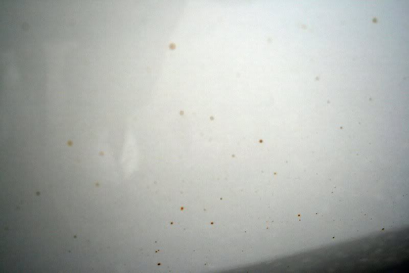

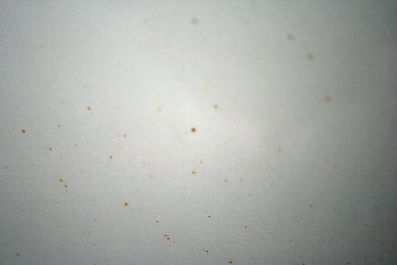

I have posted this in a couple spots and thought it might be useful pix here.
For some of you southern folk who have never seen rail dust here is a few pix ..
Rail dust originally got its name because cars were shipped on open rail cars and the filings off the rail car wheels and tracks were magnetic and stuck to the cars paint. And when it got a little moisture with it it created the little brown rust spots.
In todays life most are from the brakes and in winter the filings off of snow plow blades.
From April to Nov I never see any of this on my car .. this is from Nov to date.
If left on for a couple of years you can see paint issues but if removed every spring there is never a problem.
Clay barring will remove it without damaging the paint . Other methods may cause marring.

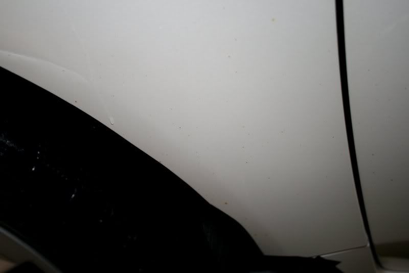

Pictures were taken just behind the front wheel and the bottom of the drivers door. You will also find it behind the rear wheel and the back of the trunk and rear bumper.
It won't be as visable on darker colors but you will be able to feel it. These are so small you hardly see them from a couple feet away .
