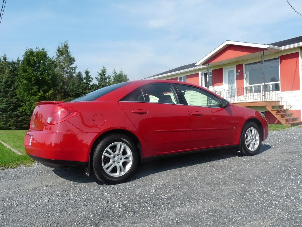

This is what I began with (the car was last washed 2 weeks ago and no polish/wax in a year) :
Nasty bugs

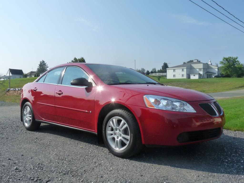

Afters :
Sorry the sun was down when I was done. Total time : 4,5 hours.
I hate those tires. I’ve never been able to have an even shine with those.
This is what shows on the lower sides. Seems like a commun problem with all G6 sedan because of the body shape. Damn, it makes the car looks like s***. It would need to be repainted.

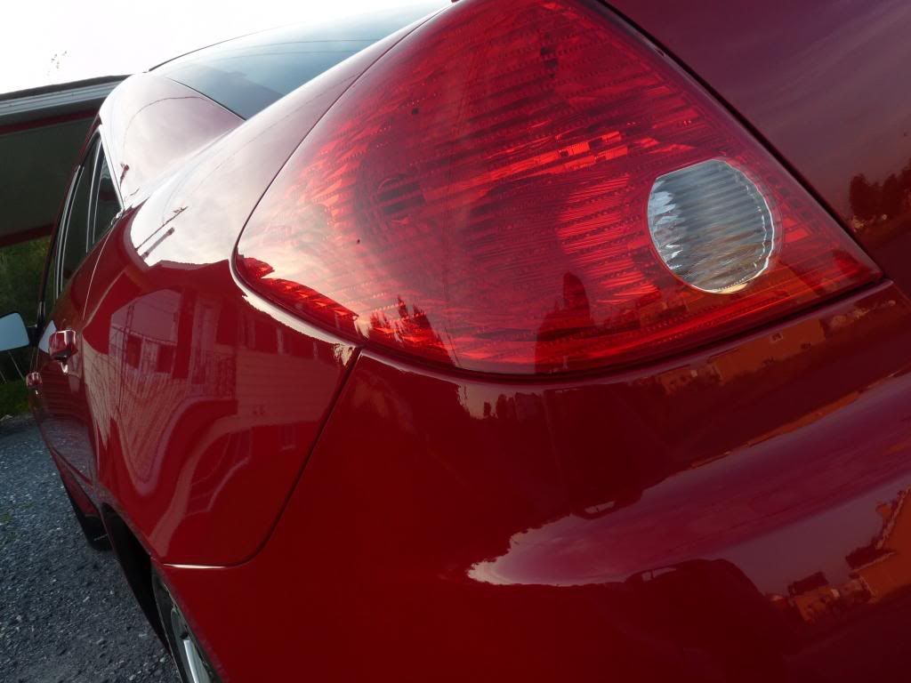

Those are pictures from this morning in the sun.
Nasty bugs
Afters :
