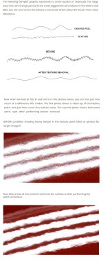

Maybe it`s me and my lack of understanding but I kinda always figr`d texture and orange peel were one and the same. After Googling a bit, it seems as this is also (albeit with different terminology) a situation that occurs in a variety of metal/surface polishing and such. Interesting.
attachment.php
I think there was a Autogeek discussion about gloss meters, which almost made me seek one out cuz I don`t really trust my eyes (everything looks great immediately after application) but now kinda backing outta that due to info I *think* I got from below article:
Gloss Meters: http://esotericdetail.com/education/gloss-meters-and-automotive-paint/
Perhaps more to appearance (shine-wise) than a gloss meter can contend with?
I dunno; food for thought or just overthinking?

FWIW, this is the vid that sparked my pondering: https://youtu.be/VRlLLsT_yYY
What I got out of it is that orange peel and texture are *not* the same thing. Orange peel is a `longer, smoother wavelength` representation of the surface, kinda like a landscape with rolling hills. Texture is a shorter, more jagged wavelength thing within that landscape (like rocks, boulder and such) are a more jagged line superimposed over the more rolling orange peel representation wave.
They do speak a bit to sanding to remove orange peel but don`t seem to like that approach on factory paint.
It may be splitting hairs but it`s all I got at the moment...reading as opposed to doing.:mellow:

I’ve found that by just a microfiber pad and a large throw DA you can reduce texture in modern paint. The gentleman in Ohio claims this as his secret crystal treatment. As said before, with clear being as thin as it is on the newer cars, no way am I sanding them flat. The Corvette guys ask about this all the time. But those vehicles are made of materials that have texture in them. So you can’t get them flat.My Challenger had a good bit of texture in it and by compounding the factory defects out we Rudy was the texture to the eye without significant reduction in the clear. And 5 years later it’s still okay. I don’t believe that sanding or compounding the paint flat and adding a coating makes up for the clear that you’ve removed? Just my thoughts?
I have noticed the same thing on new ford trucks, its looks just like the first picture, i assumed it was micro pop
It must be a product of the radial spray heads they use at the factory. I have painted vehicles for 28 years
using suction guns and HVLP guns with traditional fan spray heads, and cannot recreate this effect.
