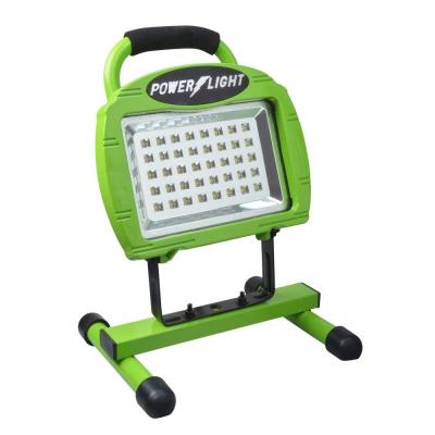

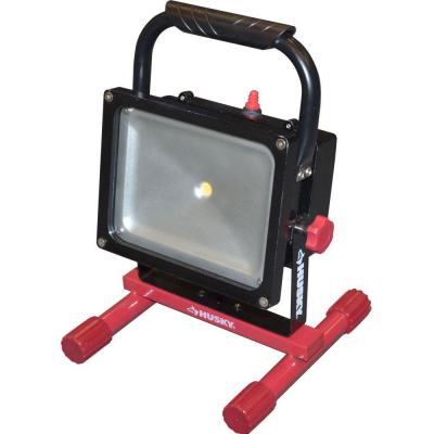

Hey wreckage…. the LED's that you posted above are the wrong kinda LED's you want to be using for paint correction imvle….
Those particular LED's have a cluster or a bunch of smaller LED's in it and will wash out the area you are trying to light up and therefore you won't be able to see the scratches & marring as easily as you would using an LED with a "Single" diode or single LED in it.
Here are a couple pics to show you the difference……. The one on the left is the one you want.
HD has these for half the price as the one you posted above….. check them out!
