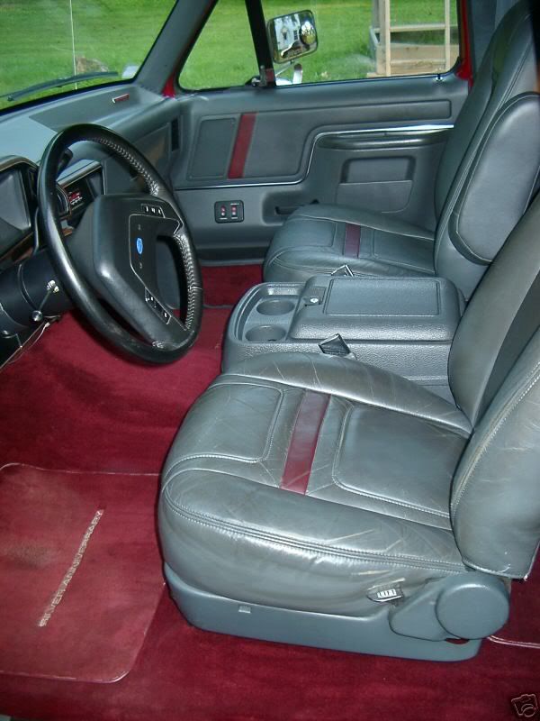

Just came across a pic of my interior before leatherique. Hope you can see the difference because its not all that noticeable. However the leather is softer that before.
Before
After
Nice work David703! I do see a noticeable difference in the shade. You can see the brown tint from dirt and body oils. After your process, I can see the clean bright leather. I think it is a big difference.
