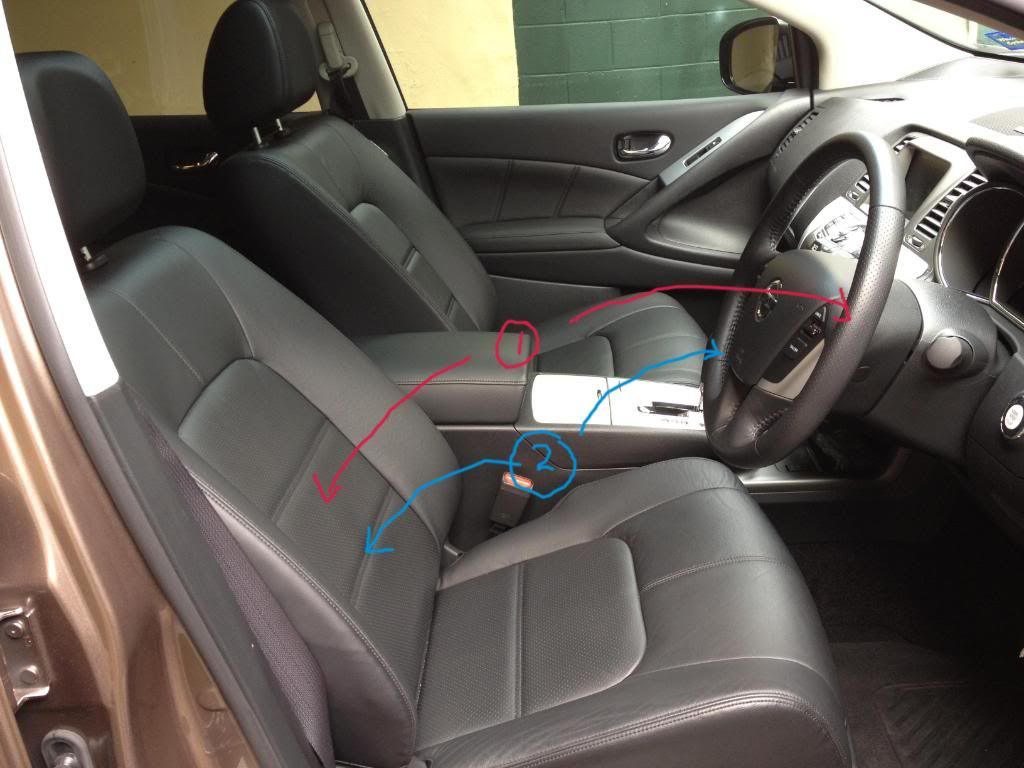

Frankieplus said:
So I put a drop of water on my seat and it just sat there.
But when I wiped it, the smear of water dissapeared as fast as alcohol would dissapear.. Water doesn't evaporate that quick!
So what's going on? Coated or Uncoated?
New Car.
-Frankie

The answer to your question is “Coated”
It is a coated leather using opaque Pigment for coloring and sealed with a soft urethane coating that also determine its final luster.
Uncoated leather is refer to as "naked" leathers found mostly in ladies handbags like Louis Vuitton and Coach, also known as vachetta leathers.
In auto interior the other finishes is known as "aniline" leathers, like those found in the Ford King Ranch; only difference is that they are colored with transparent dyestuff, yet are still coated with an urethane topcoat that seals the color for better wear and from bleeding.
A term for leather has to apply across the board ranges from auto leathers, furniture, garment, bags and other accessories to be meaningful and understood.
So leather cleaning is all the same, need to classify only the finish type, be it an auto interior or a leather jacket or a briefcase.
Your water droplet testing is “not the industry standard”.
That’s why you get the weird result.
The standard testing is to allow the water droplet to darken the leather through the finishes to determine its absorbency level; primarily to determine if the leather structure is pigmented, micro-pigmented / semi-aniline or aniline.
This standard water droplet test applies to all segments of the leather industry; including when buying a pair of boots, to know whether you will have sweaty feet after wearing it; is determine from the same test.
Leather absorbency equals breathability equals seating or wearing comfort, the higher the breathability the more expensive the leather is; that why you see more and more auto pigmented leathers that is perforated primarily serving the same purpose, other than look.
By general appearance your leather is pigmented with mixed of perforated panel and possible to have simulated leather (a fancy word for cheap vinyl) in the non-body contact areas; to be determine after examining the pictures further to conclude.
