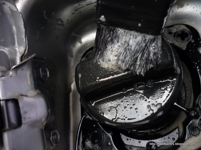

before fuel cap area
agitating
tatatata - show room condition possible
