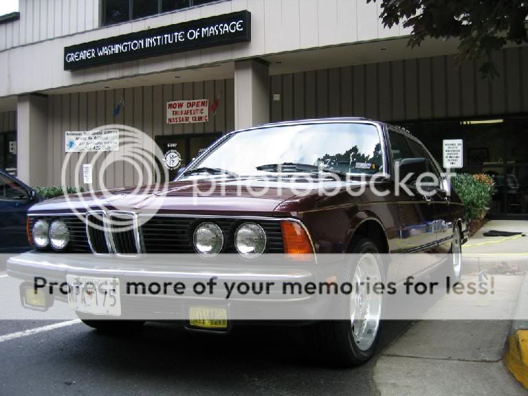

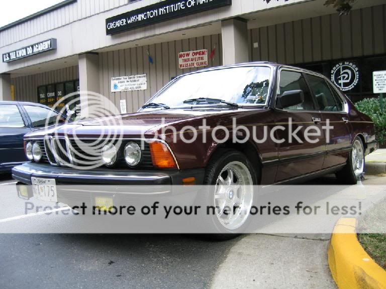

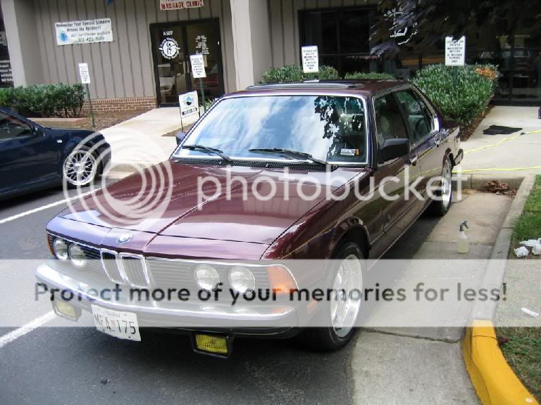

Before
After Pictures
the trunk with the new paint came out ok, almost all the cobwebs were removed.
OK, here is the problem - look at the faded paint! And that is after many coats IP/FP/VM
The other side treated with IHG already. Anything I can do?
this was the best I could do.
Lesson learned! (No more old cars)
