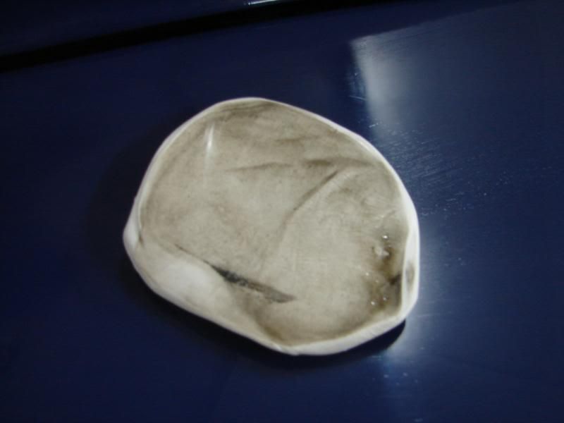

This is the clay, it was very heavily contaminated but mainly with oils and grimy residue. I suspect the shop has been giving it regular wipe downs with less then autopian standard rags.... notice the dark brown and black contaminents tells me it's not dirt but oils and such.

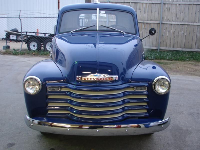

This truck just recieveds my stage 1 polishing not the full works so I only polished it out one time with the PC, an orange LC pad and some Menz IP. The paint was soft so the amount of correction with such a simple combo was quite significant.
Even though you can't tell from the pics since they are all taken after the process was complete there was some haze removed which brought out the clarity and depth of this paint.

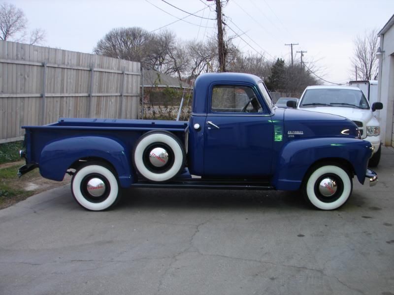

Notice how bright the white walls are. I cleaned and buffed them out with a bristled brush attachment for the PC after spraying some 303 cleaner on them.
I finished off all the chrome and windows with ZAIO as well as the body.

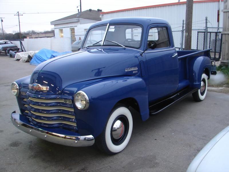

I thought this pic was worth another look....:D
This truck is almost 60 years old and the oldest vehicle I've detailed to date.

No problem, sorry I couldn't take more pics, I was so crammed for space in that shop it wasn't even funny. I thought at first with the paint only being 5 months old it was be an easy job but no way.... in that first pic of the caly you can see some of the micro scratches and haze from regular wipe downs with dirty shop towels and such.
