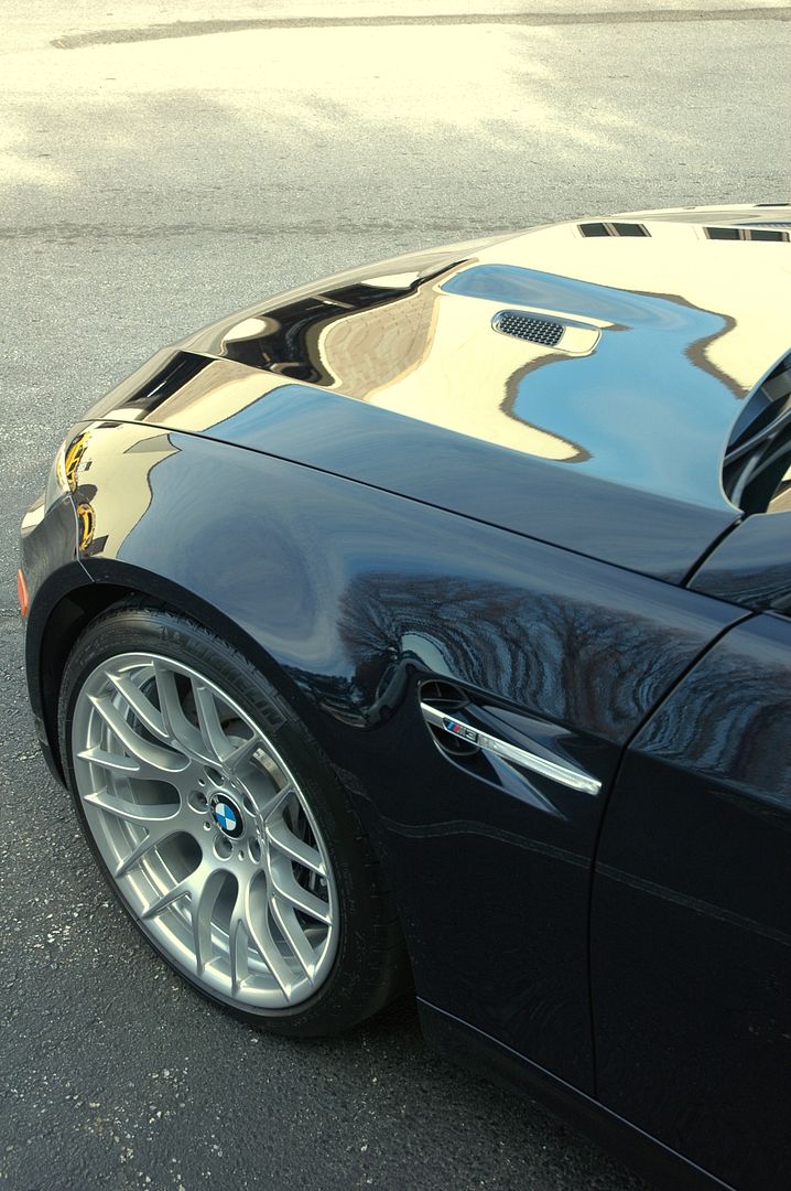

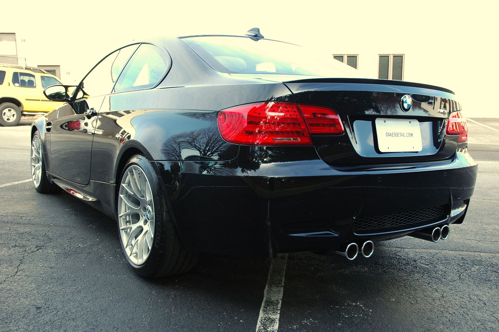

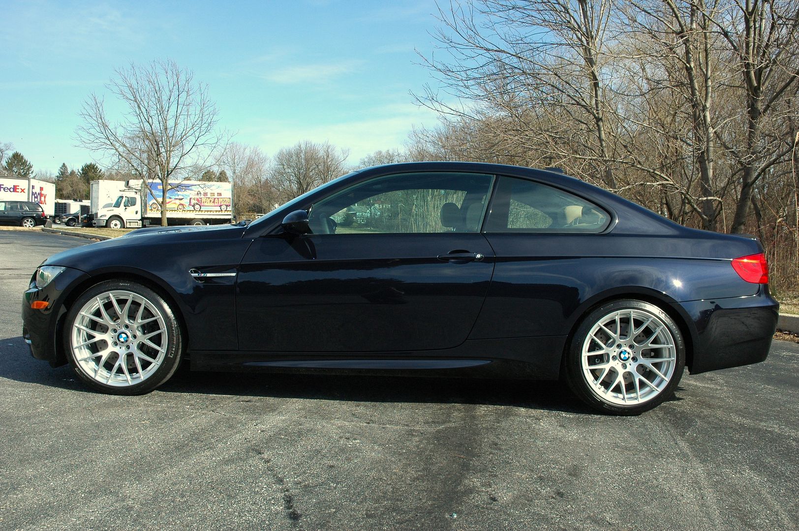

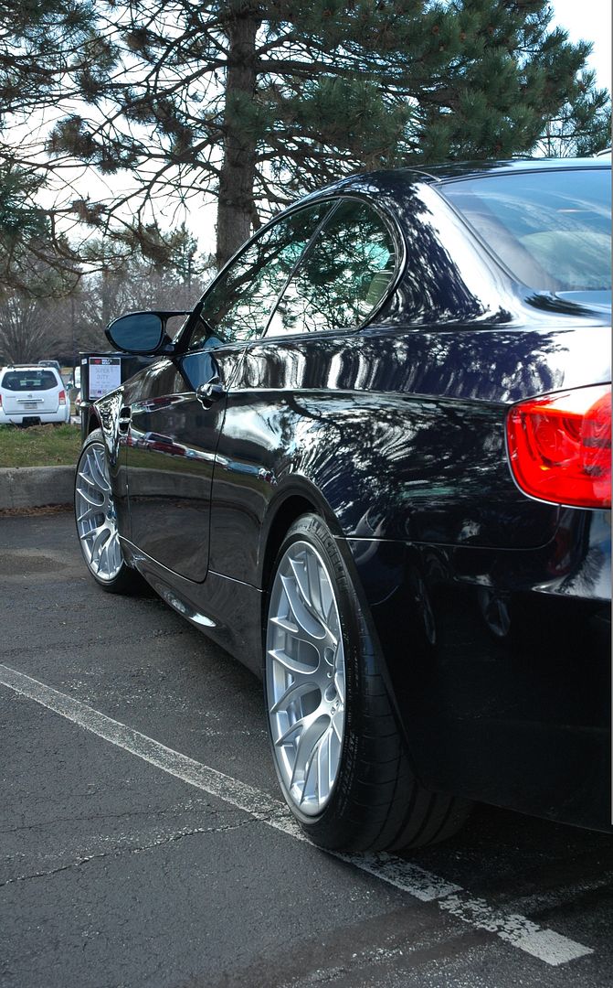

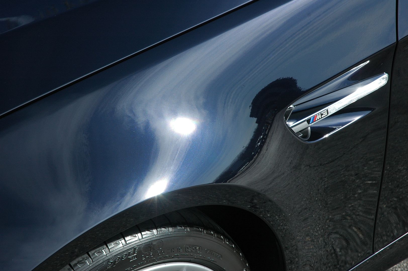

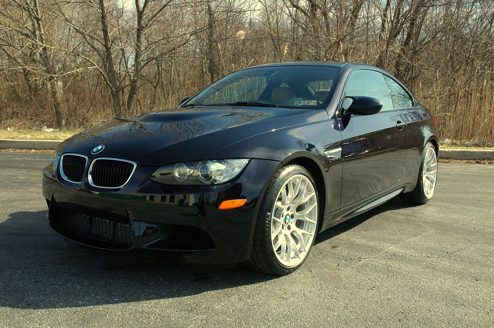

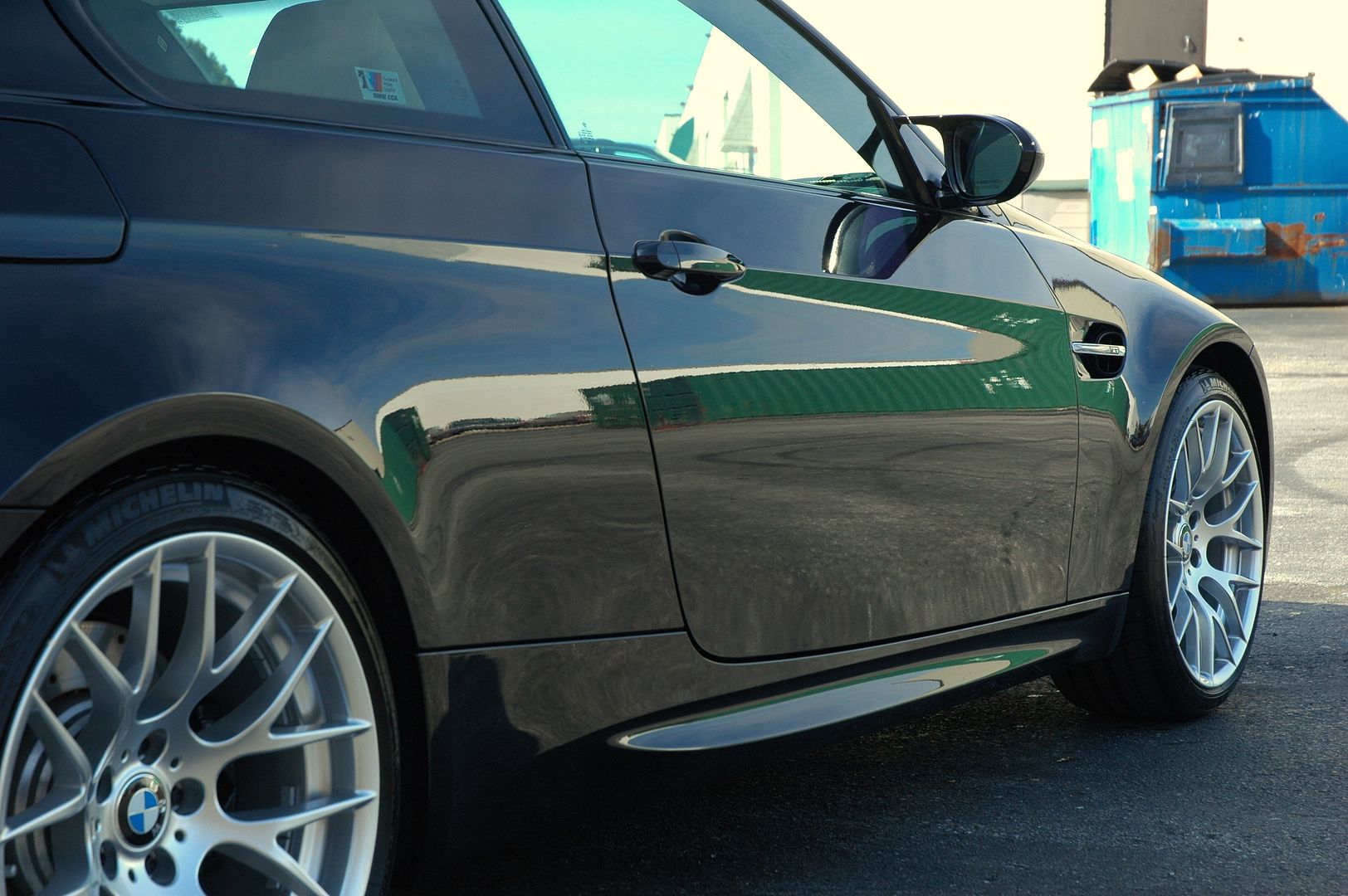

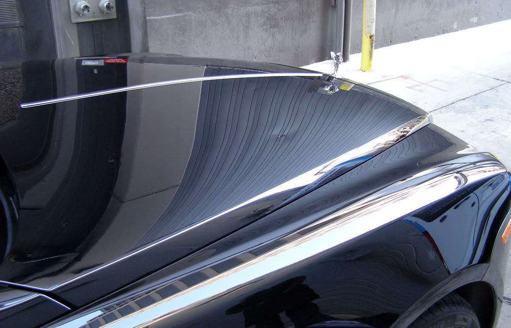

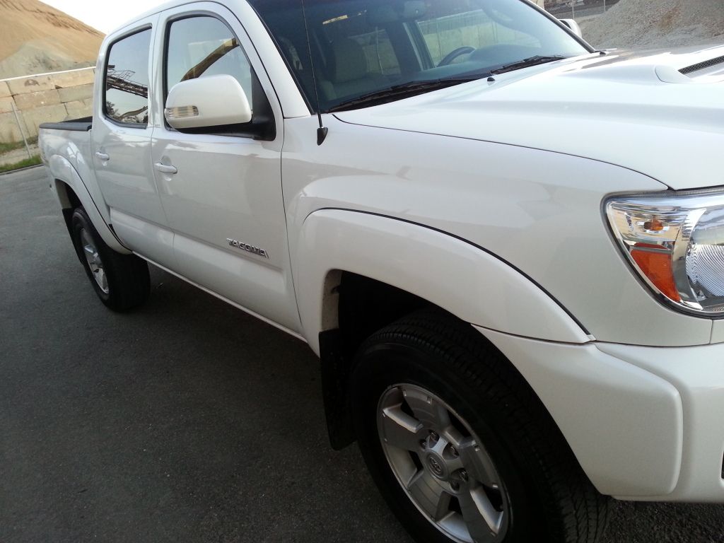

this car was corrected twice , first at delivery and second after a $20 wash or whatever that wash cost.

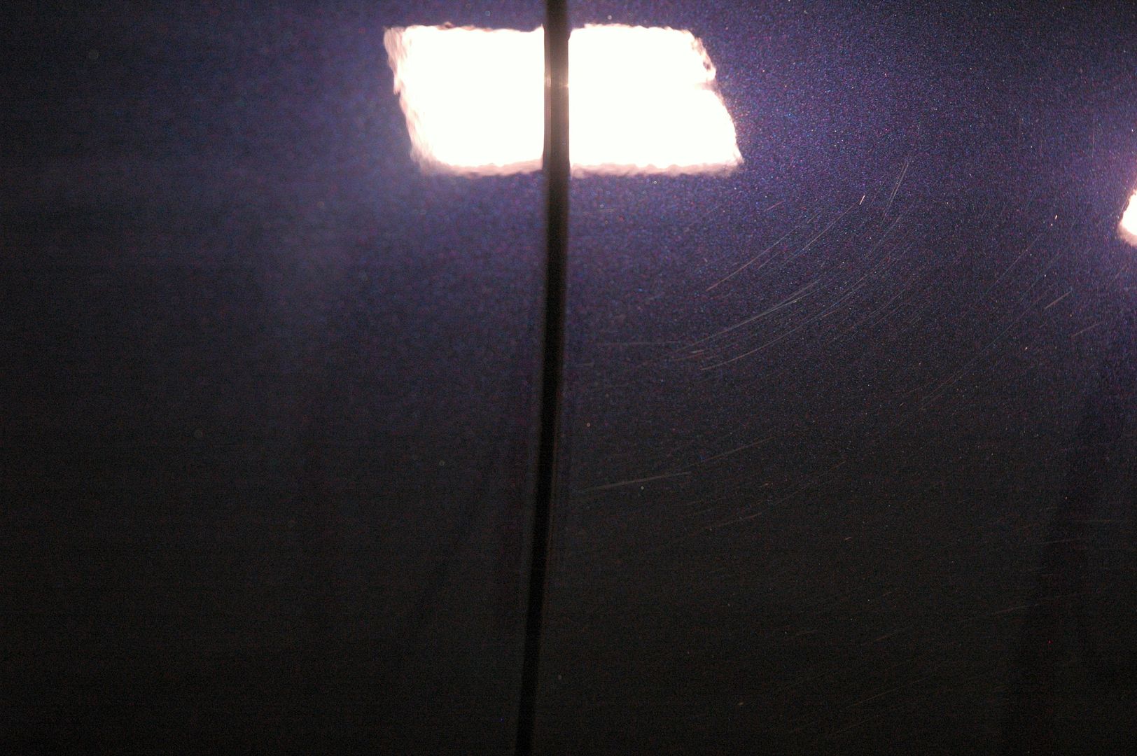

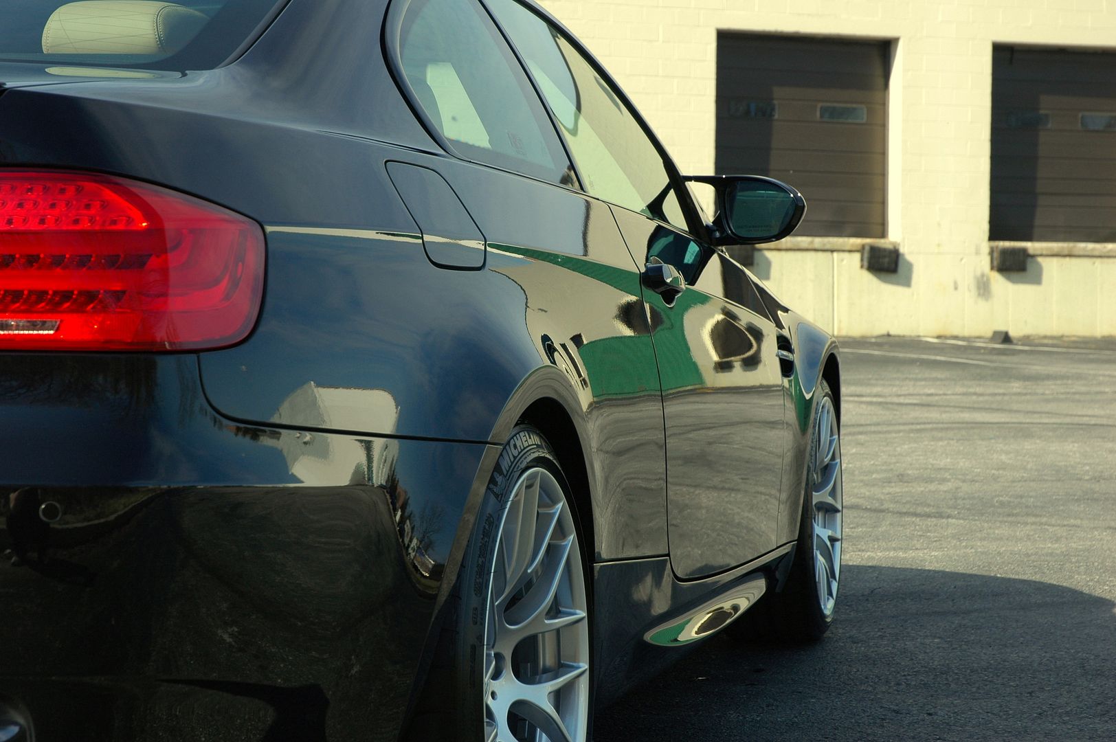

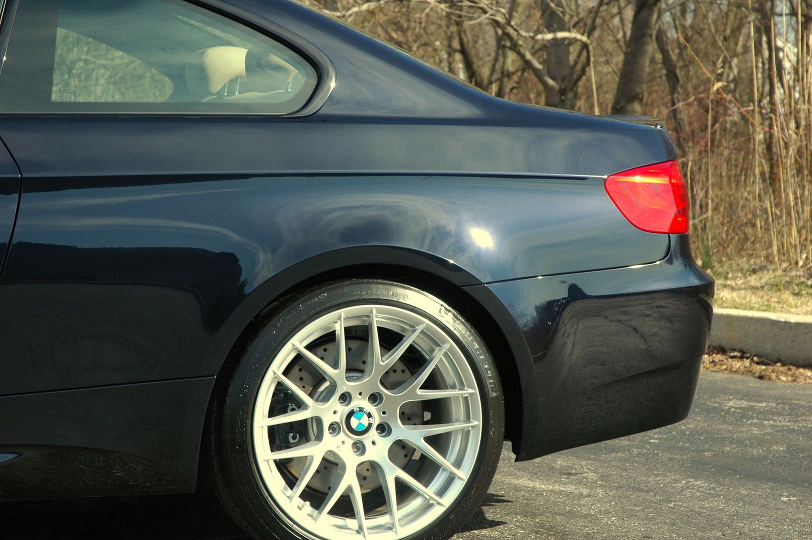

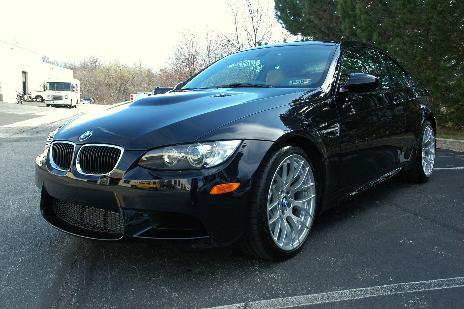

new car , it had a few spots that need to be address , light haze , a few scratches.
on the more affected area i use flex da , with cutting or polish pad and mezerna , the polish step on whole car done with da , polish pad and meguiar`s 205 . opti-seal and carnauba wax on top.
After:
IS NO DENT
fixing an improper wash ....

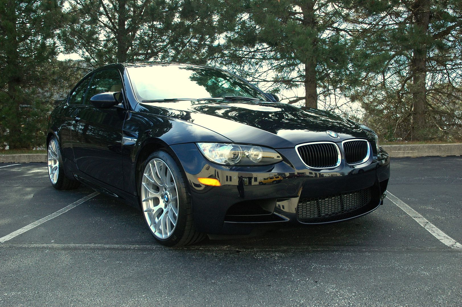

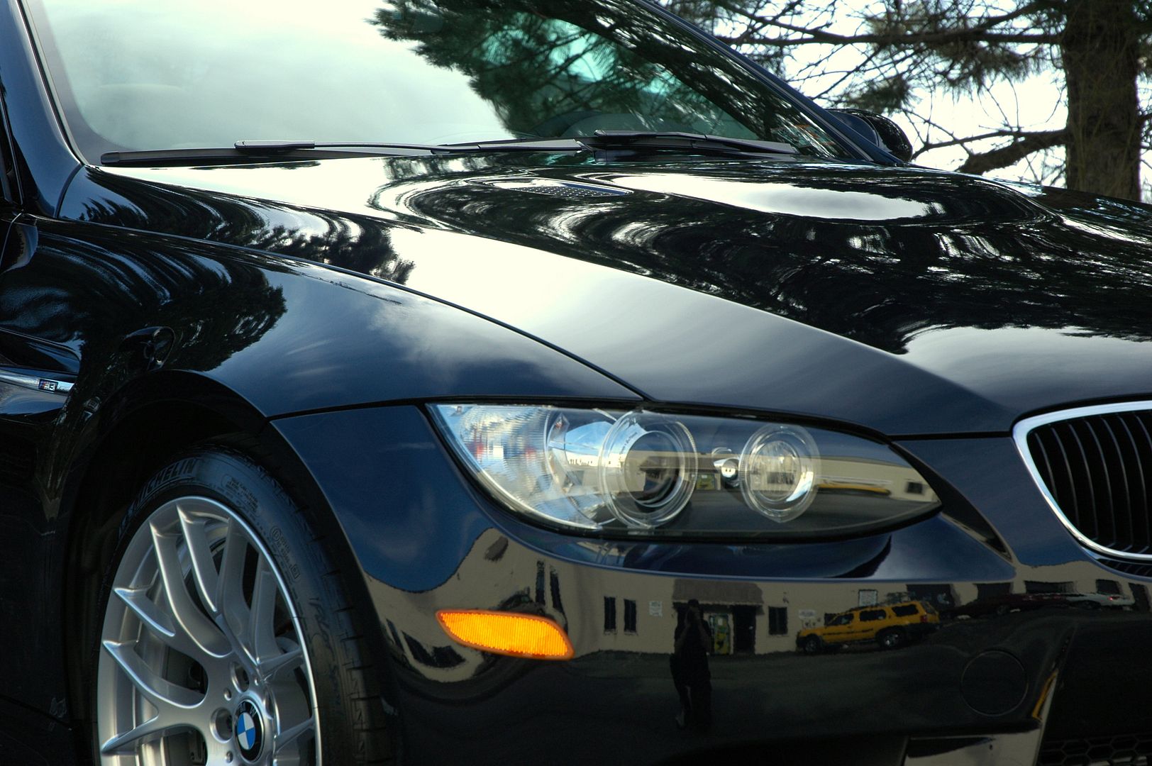

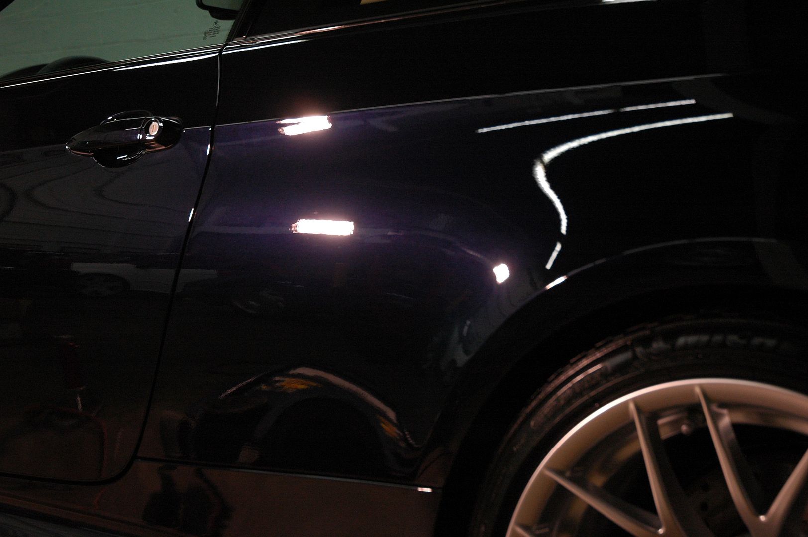

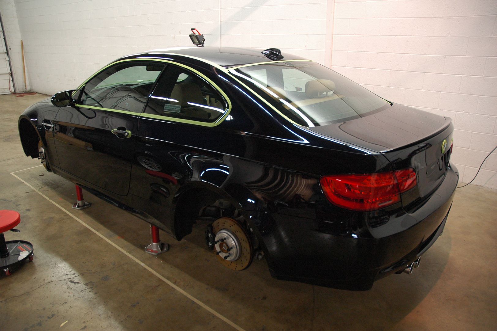

After:
IS NO DENT
