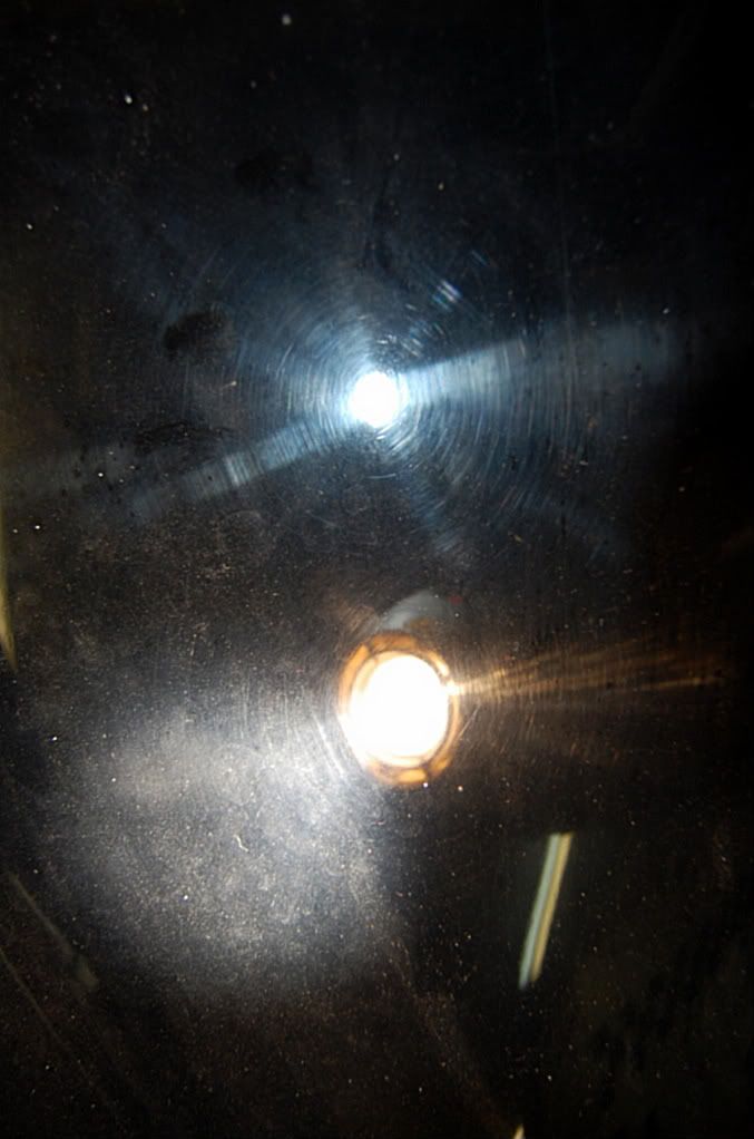

I pulled the car up and got all areas masked off that could cause a problem with my rotaries. Once all was taped I began to inspect the paint using various lighting. The lighting included halogens, sun guns , and led. .I want to see every flaw in the surface. SO here is what I was looking at.
Don’t hate me for this halogen light mixed with LED’s This is my favorite checker. I like it more then the 3m Sungun. Check how the LED’s show the Halo’s and the Halogen shows the swirls.
As you can see this car had some serious swirls. I mean its one thing to relevel paint with clear coat, but when you relieving single stage laquer in this condition it can be nerve wracking. On mistake and oops there goes an edge or a nice burn.
During the leveling stages various sheets of paper were used ranging from 800 grit to to 2500. The sheets were a mix of Mirka and Mequiars Unigrit. I choose these for personal likings. Once some areas were sanded to my liking I came back over them with a Makita 9227 and a white wool pad to level the paint as much as I could without jeopardizing any paint. A Leveling compound was used. After about to 2 bottles of IPA and 12 hours later ( I think ) It was time to refine all the marring the wool left behind. At this point I used a 70 PPI ( Pours per Inch ) Foam pad and a Makita 9227. A Medium based compound was used that finishes down very nicely. During both of these stages I had a 3 inch pad of equal standards on my Dewalt DW849 to hit tighter places.
