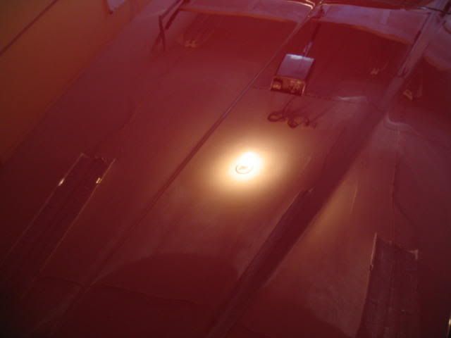

I don't do anything different with non clearcoated cars. Actually I just did a Mercedes, 80's vintage that wasn't clearcoated. Same proceedures, actually it usually is easier. Some clearcoats are so hard its extremely difficult to correct flaws unless I use a rotory. I used a rotory on the mercedes, but the paint was very oxidized.
Just remember that with each polish you are removing vital layers of paint, unlike a clearcoated car. So keep checking your work and do just enough correction for each situation.
Here is a pic of the mercedes when I was done.
