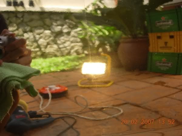

83 can cut pretty good, here's a picture , I gave it about 4-5 passes.
Half and half:
Before
After
M80 can remove light swirl marks, I use it for removing swirls marks that I get from regular washing.
M80 half and half :
