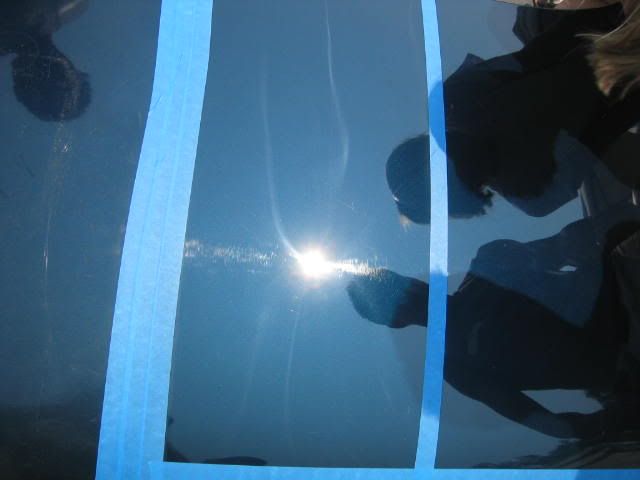

We used it to take out wet sanding marks and then finish it up...
the left side is untouched
middle is polished with wool pad
right is final polished with polishing pad
