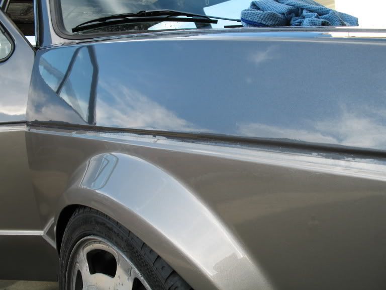

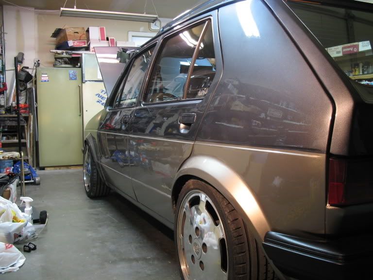

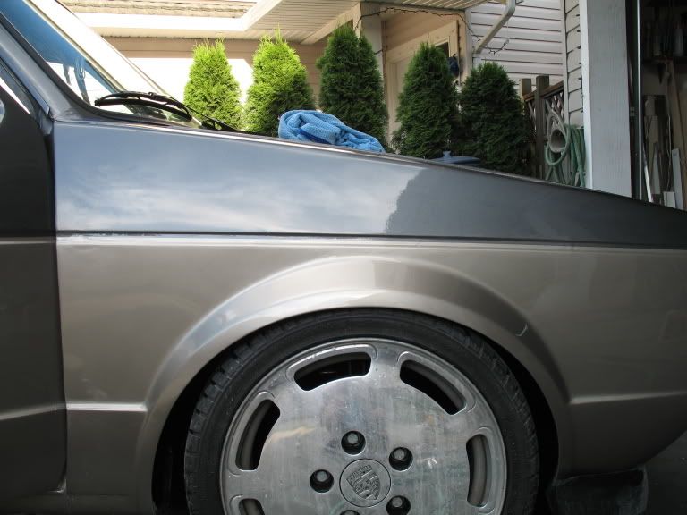

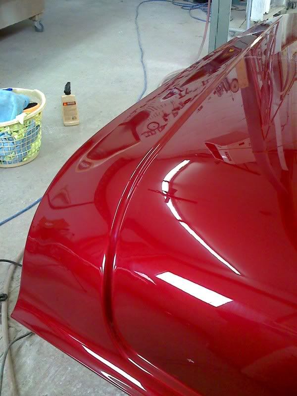

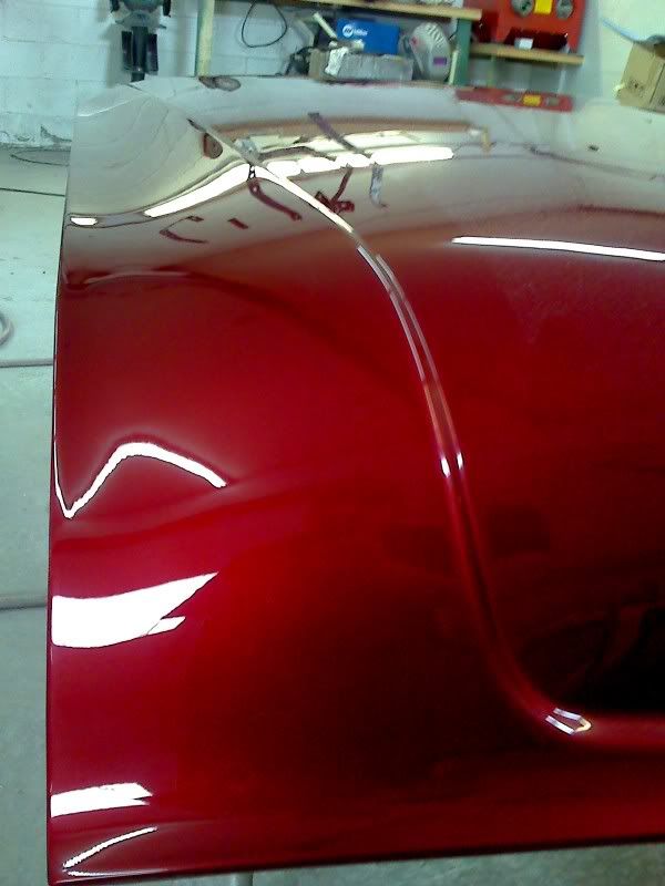

Luckily I had told him months ago that I'm a proficient wetsand and polisher, so he gave me a ring and now I got the job... But I'm still wondering how I can turn this into my specialty considering the $$$ involved with a custom paintjob on a hotrod can easily reach $20k... And the wetsanding and polishing is what really makes a great paintjob stand out from the rest.

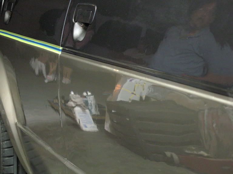

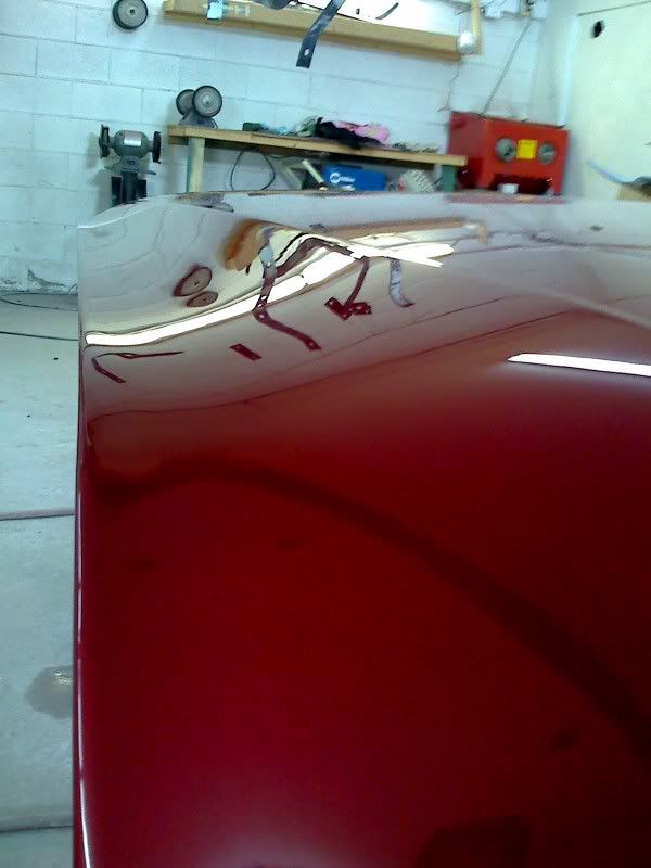

Here are a few pics I took with my camera phone (really bad quality, and I think I just finished compounding and not polishing at this point):
I have 5 hours into the hood alone which is done, trunklid is done, and I've sanded one of the doors so far... Lots left to go!!
What do you guys think a good $$$ amount is for a job like this? Overall I think I will have ~30 hours into wetsanding and polishing.

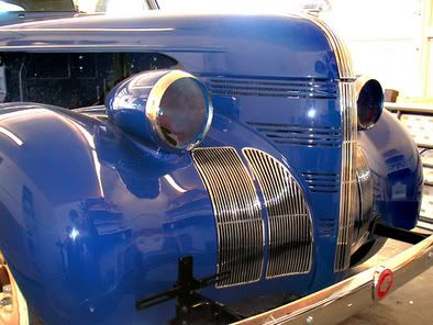

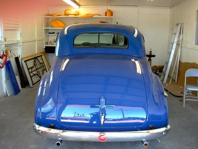

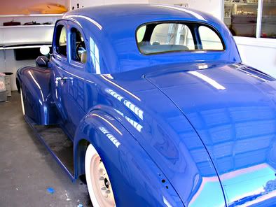

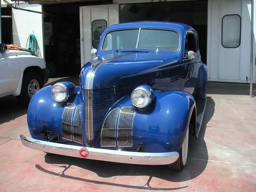

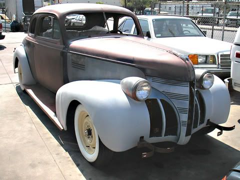

Here's one i painted/polished a while ago (39 Pontiac):
The wetsanding/polishing took over 40 hours. 4 coats of a high solids polyurethane
clear, sanded 1000 - 1500 - 2000. This is clear is "soft" by any standard...

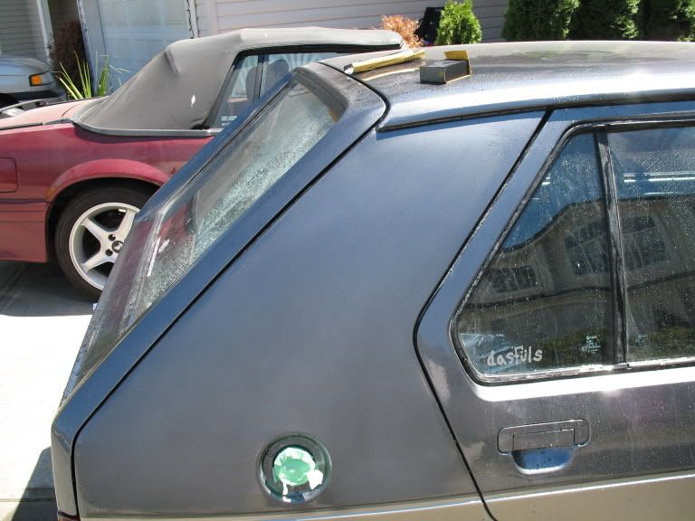

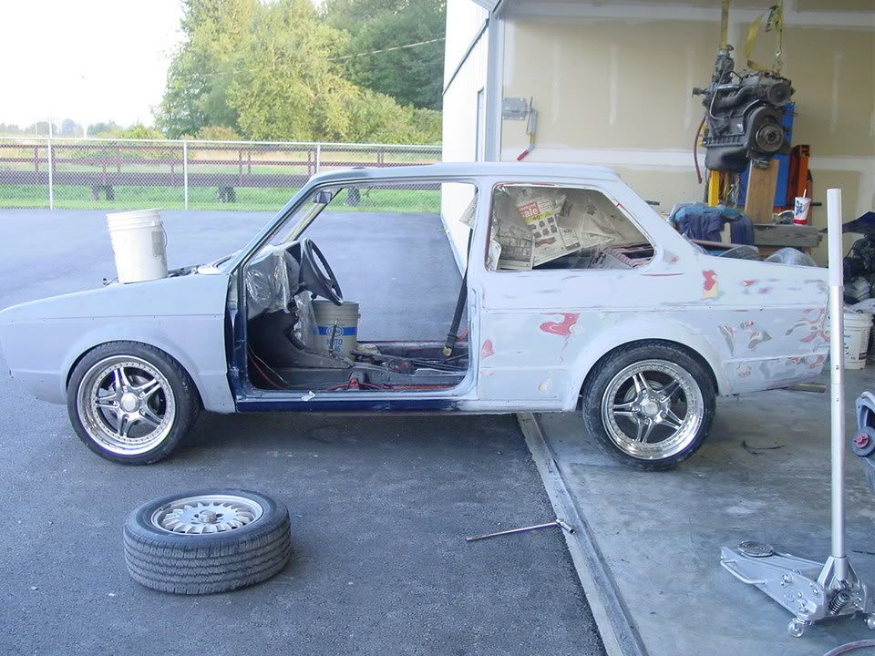

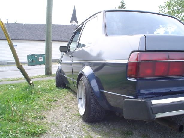

As soon as I turned 16 I had a car, of course. 1997 VW Golf. Black. Beautiful car, and after a few years I learned how to polish it about 50%..

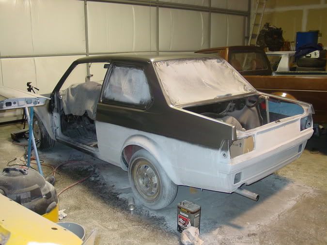

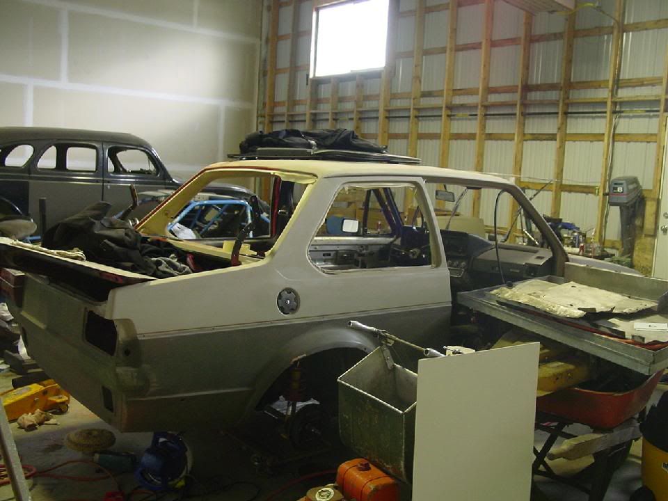

I have done some painting of my own, here are a couple pics of my...fourth....sixth? car, I painted this almost 5 years ago, so I was 18 or 19 then...
FOR THE RECORD: I knew I was not doing this as well as I could have, it was my daily driver so I had to borrow my dad's car while I did it. I also worked full-time and detailed part-time while I was doing this. So that is why I used the army colors as my initial primer.

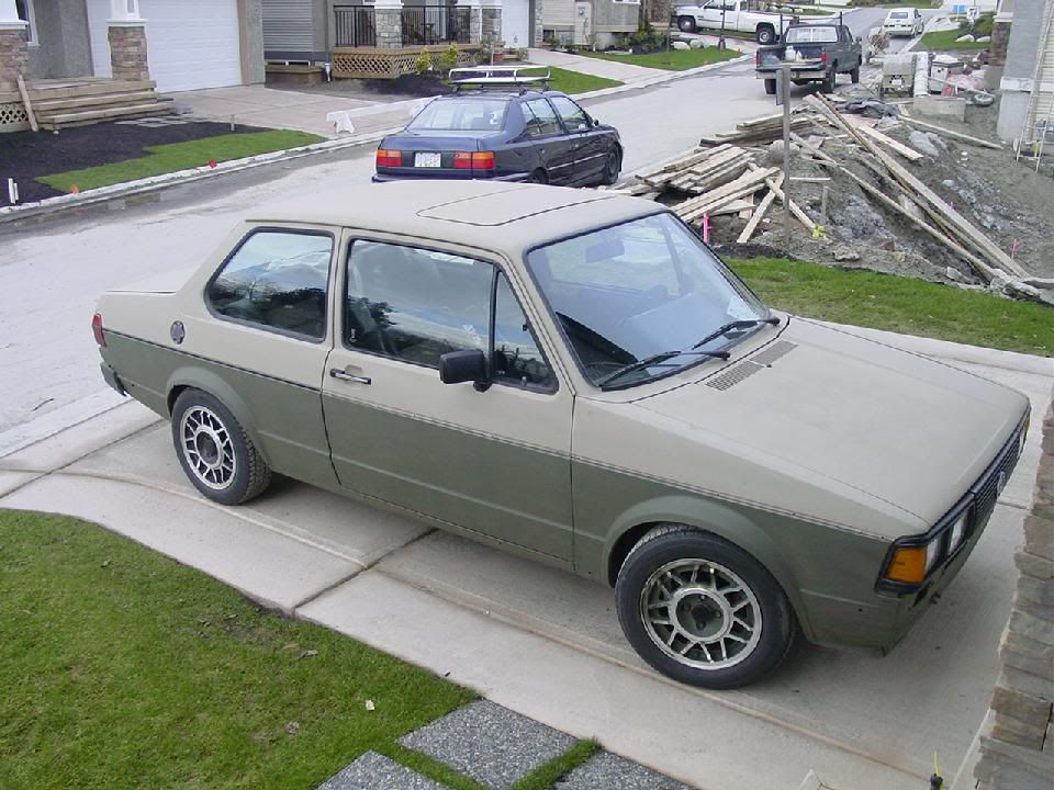

Ok, here is the car when I bought it:
Hated the red so badly I needed to change it quick while I searched for a space to do a paint-job properly... So rattle-cans, army colors, and some masking tape and I had it at least NOT RED!
Started getting it ready for a real paint-job... Big plans... two-tone silver and blue... round headlight conversion... fun times

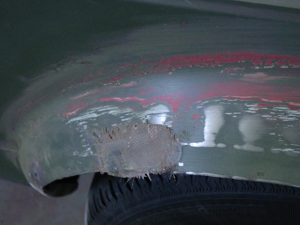

Previous owner hacked the car up REALLY badly.. Rolled-out and cut fenders, with bad fender flares BOLTED on.. Bad big-bumper conversion with holes in the fenders for LAG BOLTS... bad news

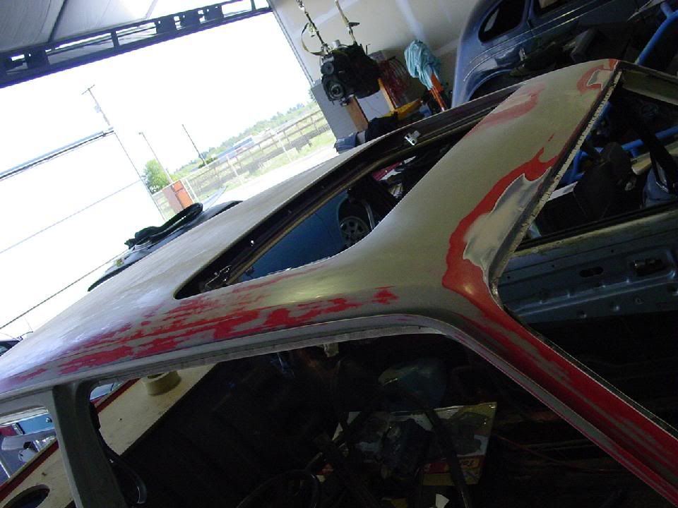

Every dent was removed, including sunroof dents:

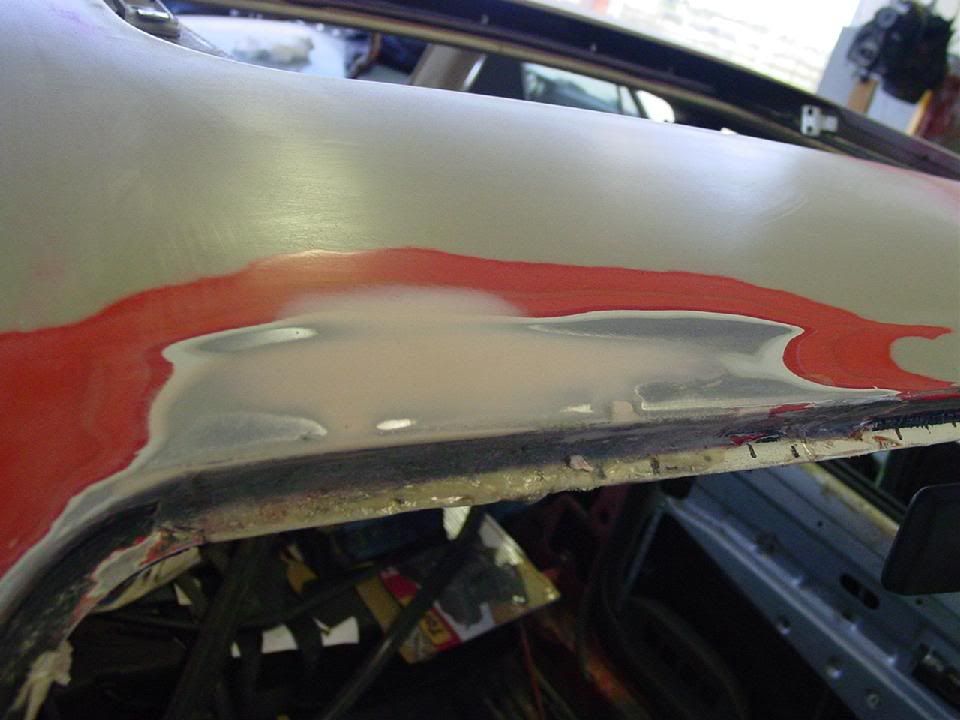

Roof was sanded
More dents filled:

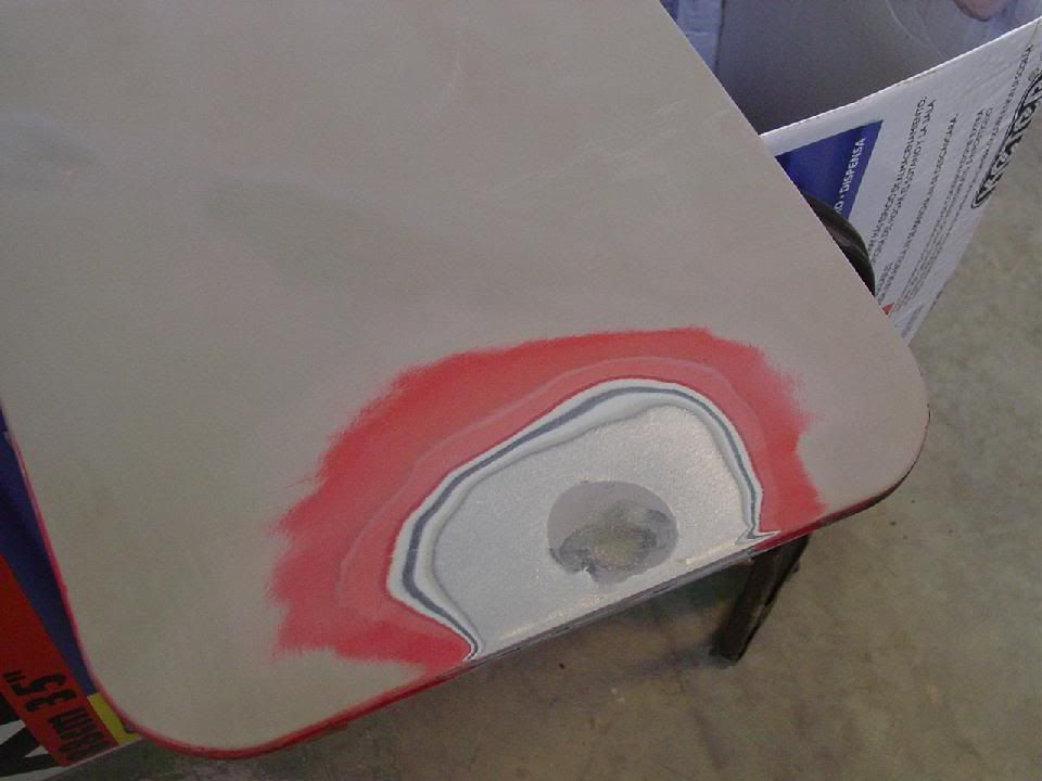

The entire bottom of the door was Bondo from previous owners... I couldn't bear to sand through it all to find no door left so I patched over it as best as I could...
My dad's Porsche 914 I had to detail after to clean all the dust out of! (Car was pulled out whenever I painted of course). Trunklid had tons of small dents...

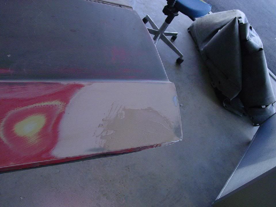

Bodywork done on the fender, primering:
Sanding the first coat of primer, threw some nicer wheels on just for fun:
Painting stage:

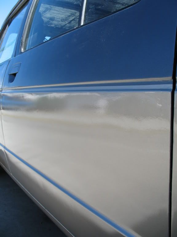

And, I am embarassed to say, I NEVER DID FINISH! Didn't wetsand this section:

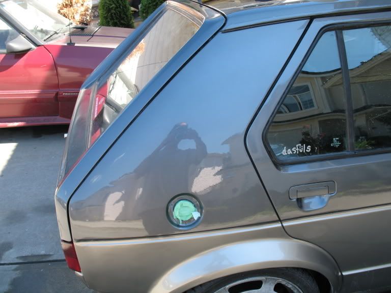

A couple other wetsanding endeavors of mine:

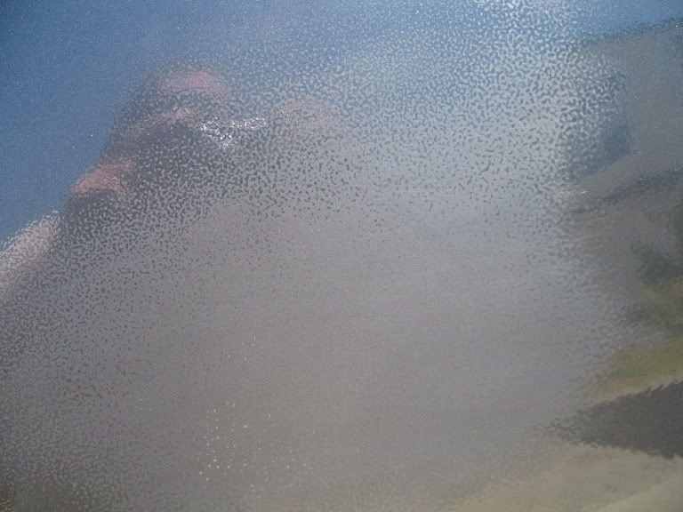

This was a friend of mine who painted his car in his garage, with an actual spray gun and all that... I think he copied me....but hey...imitation is another form of flattery!

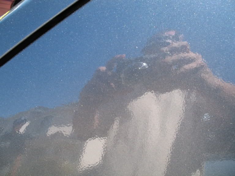

Orange peel was BAD!!!
But Stumpy is here to fix it!
Break it down and its real simple... Sand the peaks until they meet the valleys... then you're done!

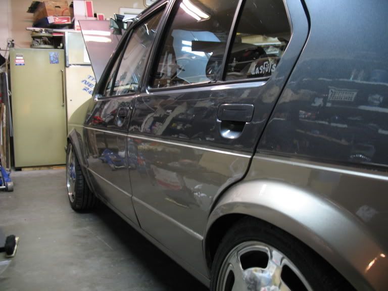

My Rig at the time: I think I was 20 or 21 by now...
After sanding before polishing:
After polishing:
More after pictures:
His dad is in the reflection... as are everything else in his garage ;)
