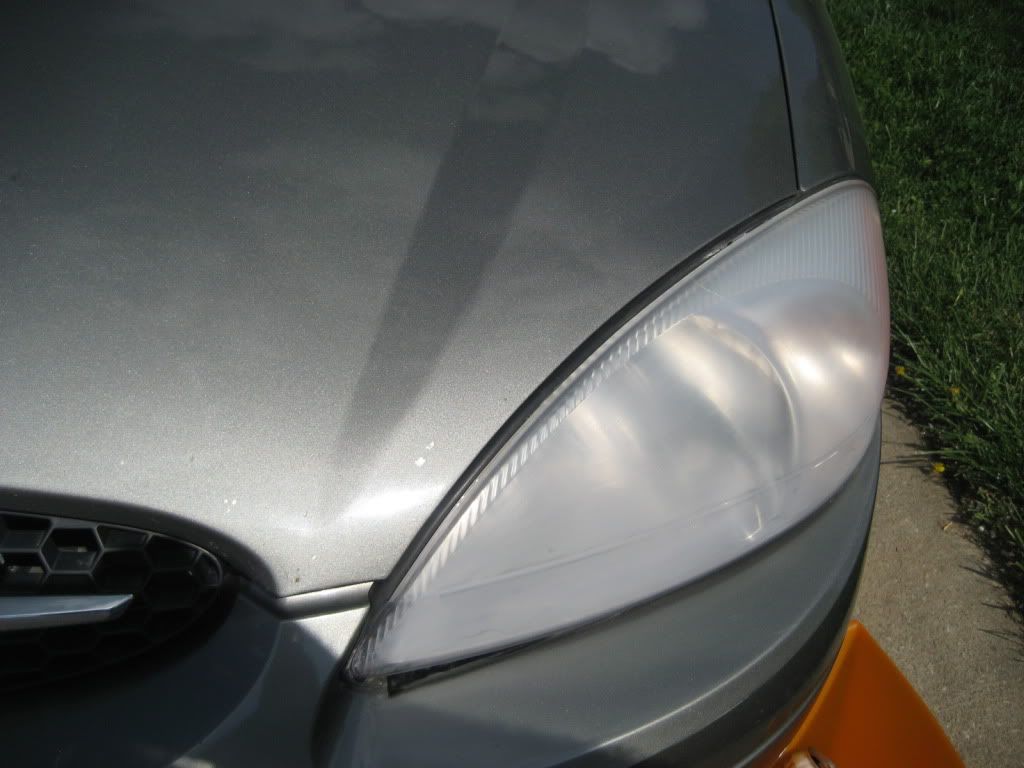

There is a HUGE difference between non-clear-coated plastic headlights and the clear-coated ones, from the standpoint of restoration!
I have spent hours correcting clear-coated GM headlights and they came out "OK"...
These Ford Taurus (non-clear-coated) were a piece of cake... start-to-finish... 20 minutes.

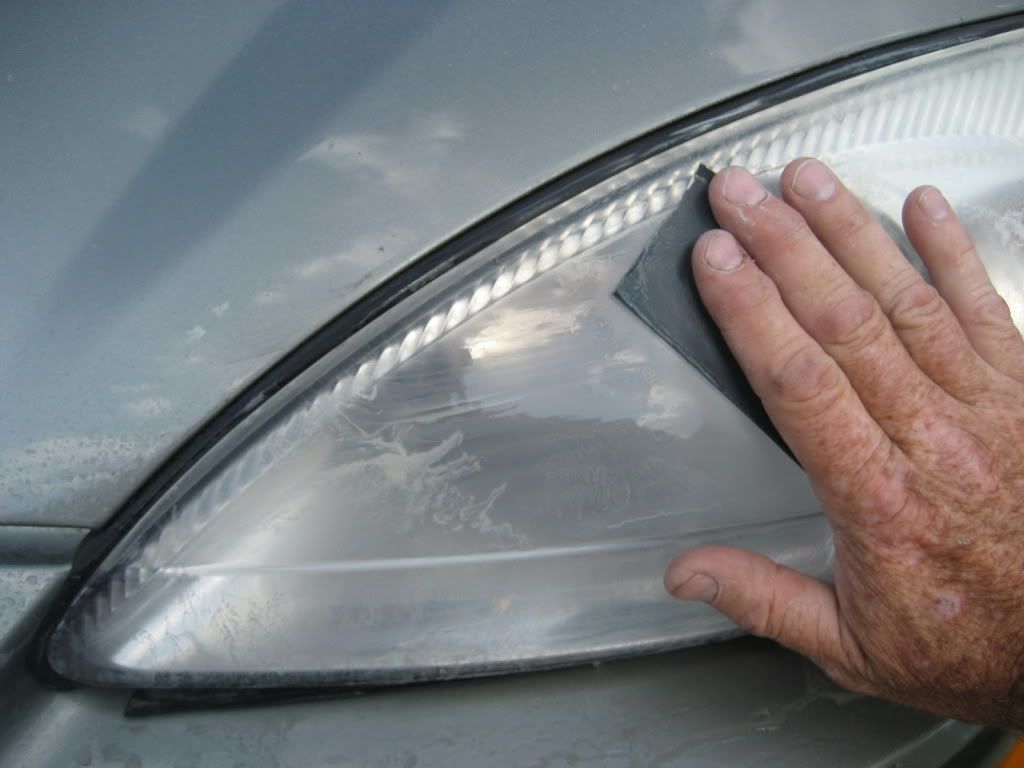

Wet-Sanded with 800/1500/2000... keeping it very wet.

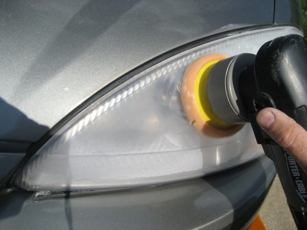

Polished with PC/4" LC Orange/M105 for 2 minutes on speed 6.
Polished with PC/4" LC White/M205 for 1 minute, speed 5.

BEFORE:
WET-SANDING:
AFTER WET-SANDING:
POLISHING with M105:
AFTER:
