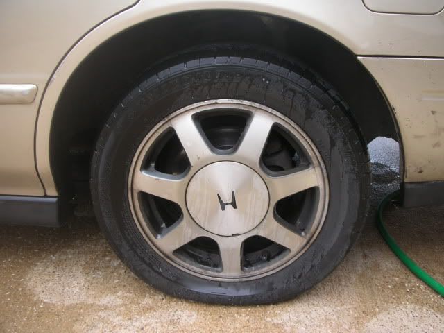

which I know is futile as they aren't in the best condition because of curbs and what not, but this last bit of break dust is driving me nuts.
now I started with them looking like this, been probably 6+ months since they've been cleaned, and they've never been cleaned beyond what is visible from the front (I'll be pulling them soon to get all the tar/rubber/brake dust thoroughly off).

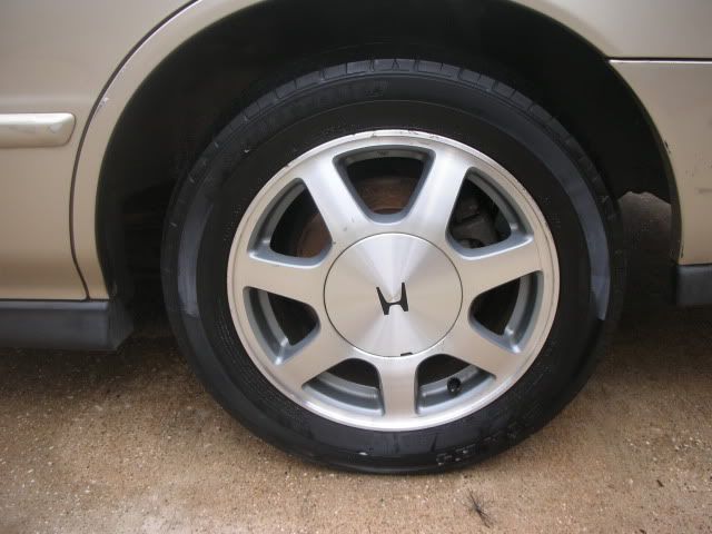

after about 30 minutes per wheel using simple green (EEK I know) but I didn't let it sit long, it was a spray, scrub, rinse off within a minute, car wash soap for a while and then another helping of simple green maybe every 5 minutes. I used an autozone "EZ detail" brush, thankfully I bought 5 of them as I broke 2 in the process of cleaning these rims.

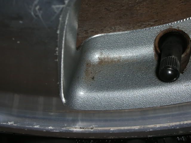

pretty good from far but:

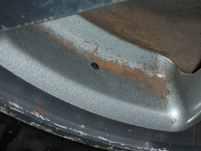

and the fronts are even worse:
I just picked up some Eagle 1 wheel and tire cleaner and I was going to give that a try this weekend, is there a better product that won't destroy the finish (if there is one) and get the rest of this crude off? would clay work?

I would get a wheel cleaner like the Poorboys one, let it sit on there for a few minutes, give it another scrub, and then try the clay, like AC said.
If I were in your shoes, I'd use some P21s gel and let it dwell for about 10 minutes, then agitate with a brush. Repeat this until you've won or until you realize something more powerful is needed.
For really baked on brake dust, and only as a last resort, I have had great luck with 0000 steel wool with a strong chemical cleaner like Megs #66 (ColorX should work as well). You will need to polish afterwards as the 0000 creates minor hazing, but it works fast when nothing else will.
In that last picture...
Is that not rust or severe oxidation? I could imagine hitting that with wheel cleaner all day, to no effect :sadpace:.

that redish crude I also thought must've been rust but after scrubbing the other wheels that had similar, it came off and revealed good condition paint.
I'll give the poorboys or p21s (which ever comes in the mail first) a try, 0000 steel wool will be a last resort as I think that is painted under there.
what is a good sturdy bristled brush for cleaning around the valve stems, as you can see how dirty those are. I bought some smaller foam brushes from HF yesterday but I'm doubtful those have the aggressiveness I need for these filthy wheels, they'll be good more for maintenance.
