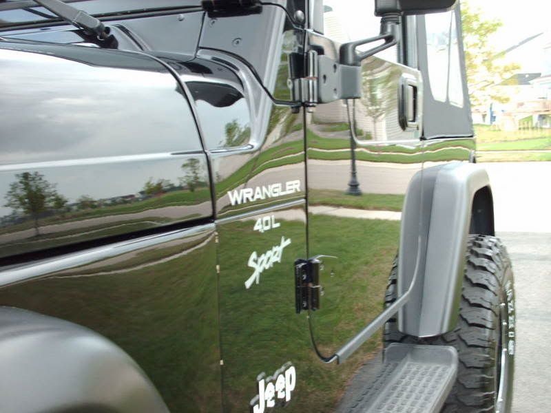

I ordered some 4" pads from CMA along with some SG.
Since my jeep braves the elements i thought i would give SG a try in hopes that a few applications later, the ole TJ will have a thick layer of protection :2thumbs:
Wash- GC shampoo
Clay - meg's clay
Polish - IP @ 6 with PC and orange cutting pad 4" / misted with OCW
Sealant - SG with PC @ 3.5, red 4" pad / removed with EO Wet wipe and shine. ( due to some streaking, i just could not get the hang of applying SG by hand ) :think:
Pictures are after wash and clay and freshly taped off. I know about the wheel wells and I know about the sidesteps, just not that important :sosad I may be venturing off road at some point this summer, sooooo :spot
