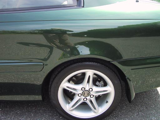

Where is a place I can pick some up at a local store to clean my exhaust tips.
You want 0000 steel wool. Available pretty much anywhere. I use it on the inside of exhaust pipes along with a strong metal polish - like Cyclo #7. For the outside of the tips (chrome), same stuff with a softer applicator, paper towels do fine on the outside of my X5 tips.
