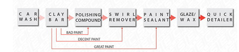

Save up your "wash" money for a couple of months and have someone that knows what they are doing detail it for you. Once you have a "proper" detail, the maintenance should be less time consuming.

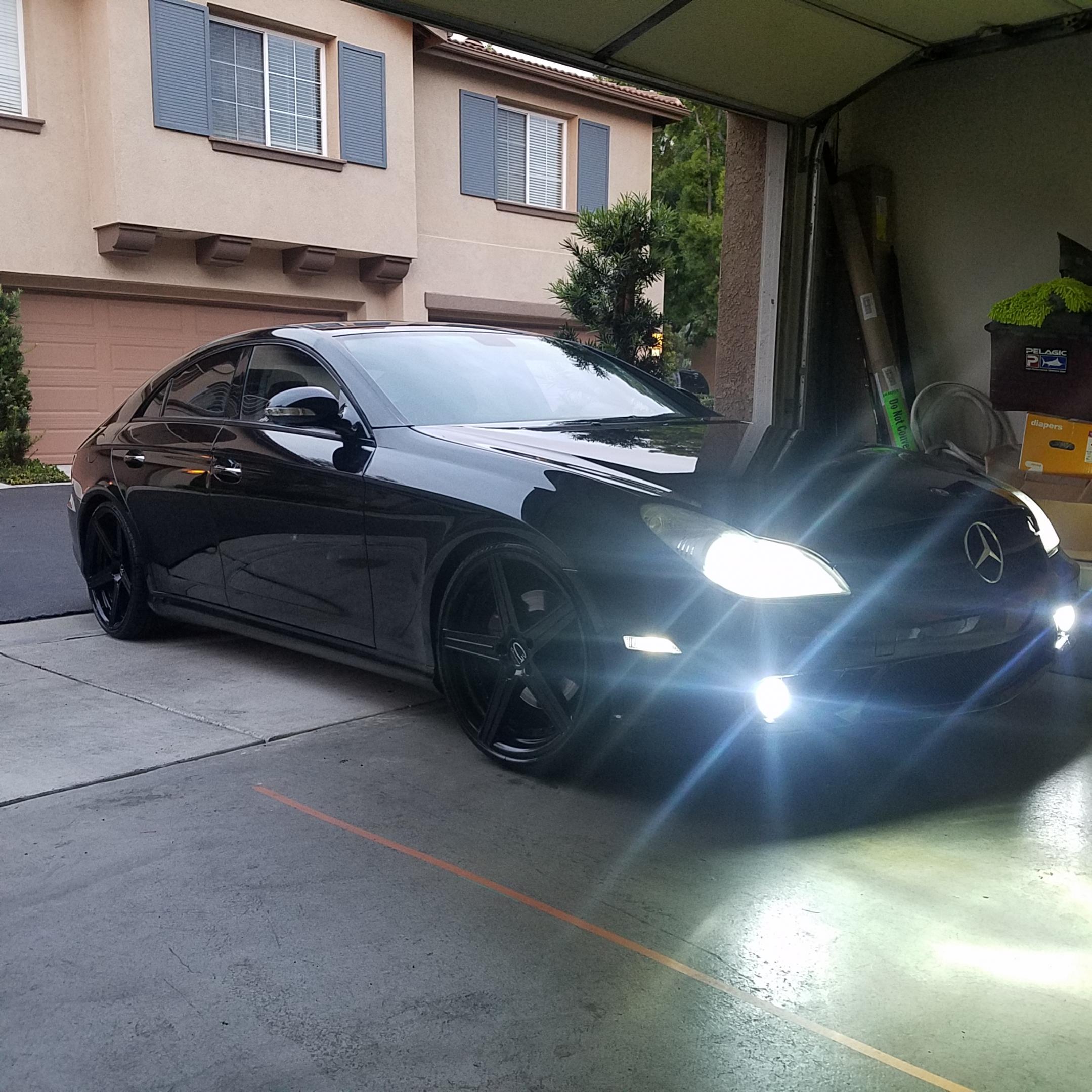

Well with young kids I do have a CLS, but it`s an 08 from an auction so lets just say it didn`t cost $72k!! That was last years project car and the entire car finished was only around $8k even though the engine is perfect and only had 80k miles on it.

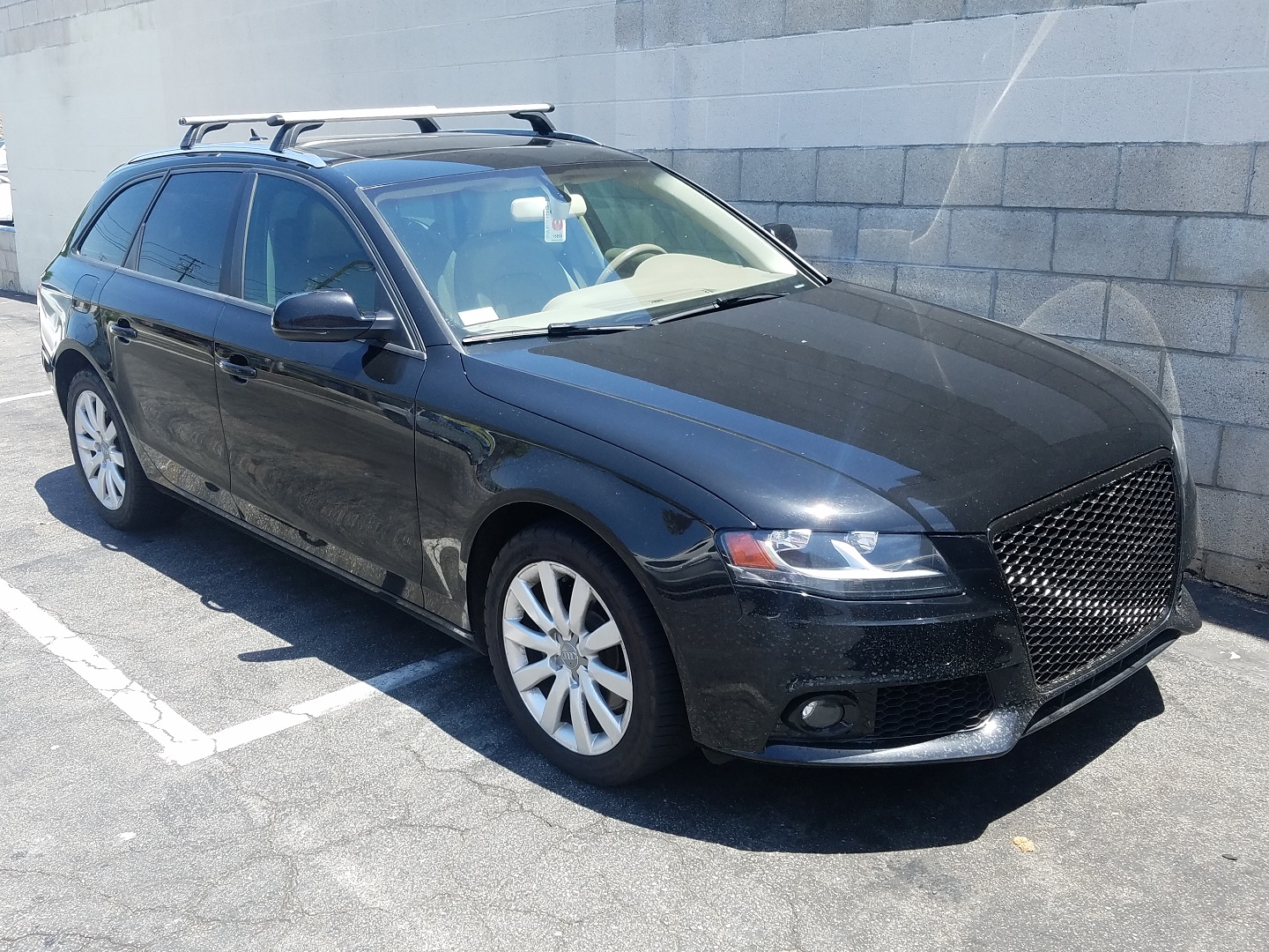

This years project is an 12 A4 Avant that`s getting coilovers on it tomorrow and some new five Axis shoes.. Again the project when done should be around $7k and the car only had 55k miles!!

LGHT --
Have taken many jet black vehicles that were so scratched from years at the the carwash, etc., that they had turned a dark, flat, gray color, and paint corrected them back to brand new.. :)
Of course, this process took lots of hours, but because of the totally neglected condition, almost all the paint was still on there, so I had a little more cushion to work the defects out and give them back a brand new E63 AMG, for example...
""So what I need to tell her is it needs a detail first to get it from a paint job that looks like a 3-4 to a 8-9 and from then my new gear is designed to "maintain" that 8-9 looking paint job....."""
This would be the way to get the paint back to nearly perfect , or perfect depending on the condition, for sure.. If this is your goal, then yes..
But with no experience, it will definitely be a long process, that can be most challenging...

Nice cars !! Love the CLS - always loved that C-Series when it first came out !
The Avant - very nice wagon !! Did only a few of those Avants over the decades but always loved the way they look when done.. Its Audi hard paint.. Will correct up nicely if it has not been messed with by drunk clowns and such...
