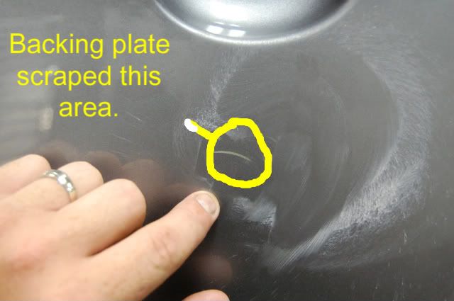

In all my years of detailing this has never happened. I am an advid fan of the all famous Porter Cable 7424. I had the original for about 3 years and nothing was wrong with it. In January of this year I upgraded to the newer 7424 xp and after about 6 months this happens. Just thought I would share it with you all. I was polishing on speed 5 with a 5.5 LC Tangerine Hydro pad when all of a sudden my pad and backing plate went flying across the room. I thought the backing plate had snapped. I was wrong!
Here is a shot of the of where it went bad.

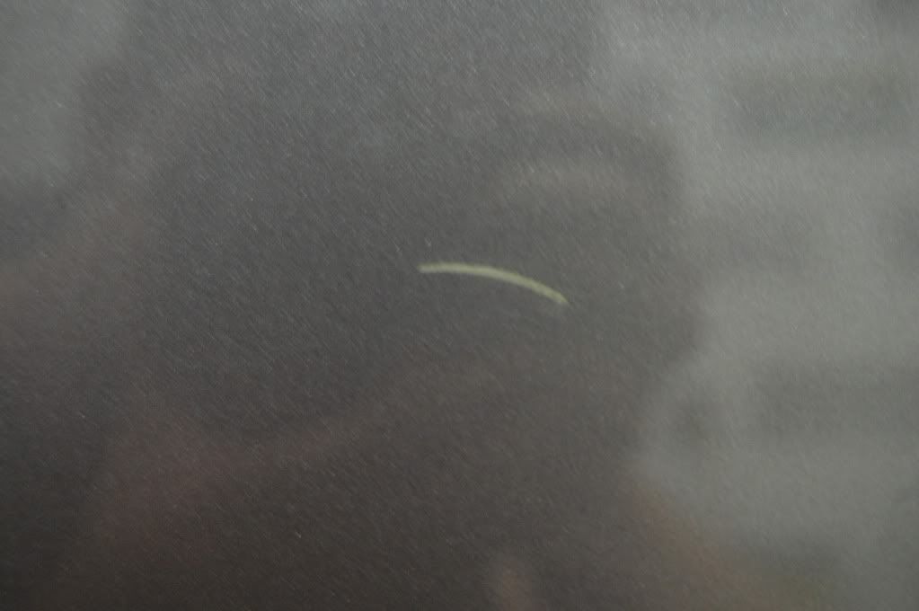

Here is the damage!
Closer up. This is deep and will not be able to be removed!

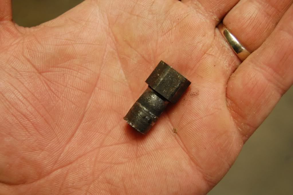

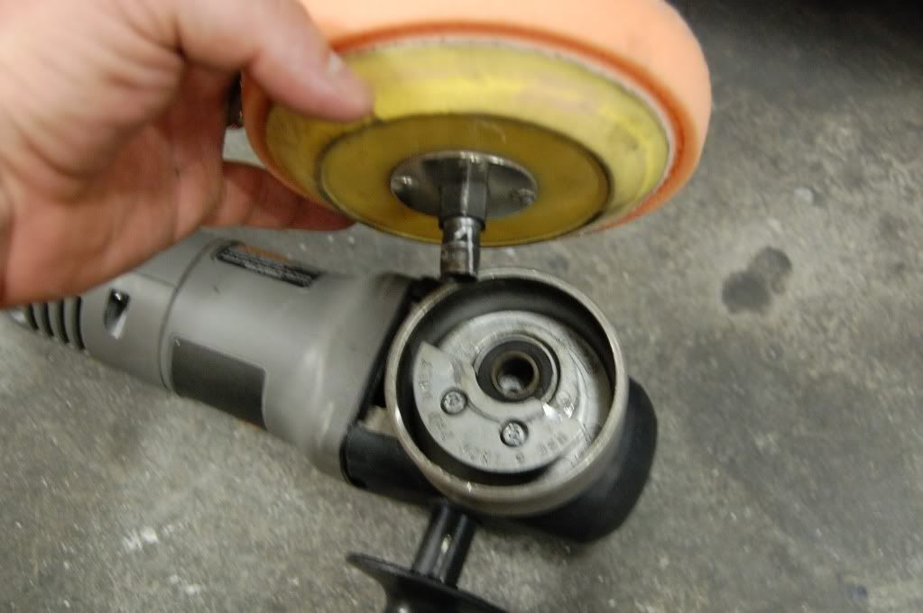

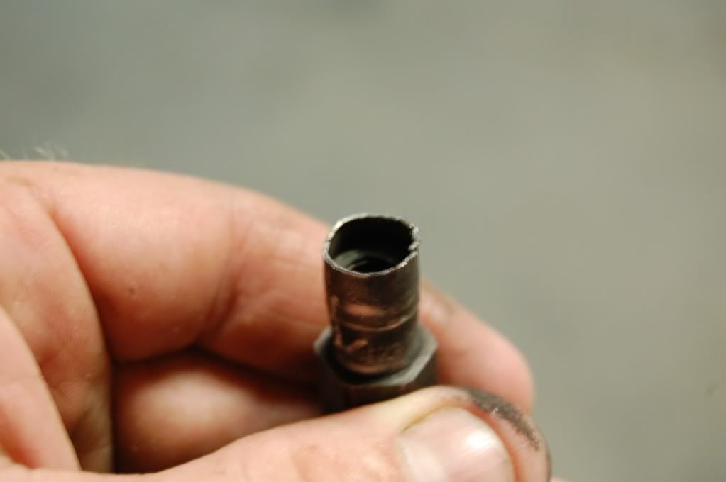

Here is a few pictures of the piece at fault.

Wow, another breakage. You're another person who snapped the rotating shaft! I broke mine on the normal 7424 last year. One day before warranty expired. Welcome to the club. I was lucky enough to not hit the paint thankfully. Though for mine, the entire mechanism fell off, meaning the counterweight and other bits...
Thanks for the heads up. Had backing plates break, but never the spindle. Looks like the crimp on the bottom sheared off.
Is that piece hollow? Is it solid on the original PC? Luckily it was a dealer car, it could have been a disaster on an exotic.
Yes the piece is hollow. I wanted to share this with everyone to give you a heads up. I'm curious what porter cable will say
