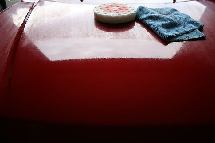

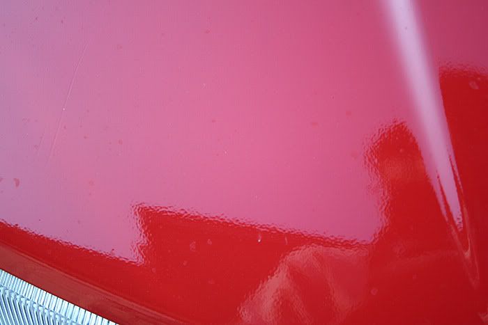

So, I painted my hood, which resulted in MAJOR orange peel. Starting things off, wetsanded with 1000, 1500, then 2000 (even 1000 was taking FOREVER), but didnt' get everything completely level, partially because of time, and partially because I didn't wanna sand too thin.
I only polished a couple small pieces of the hood so far, but the process has been Hi Temp Extreme Cut via an orange LC CCS pad by rotary x3-4 and that has still left a bunch of sanding marks as you'll see in the pics....Another day I guess.

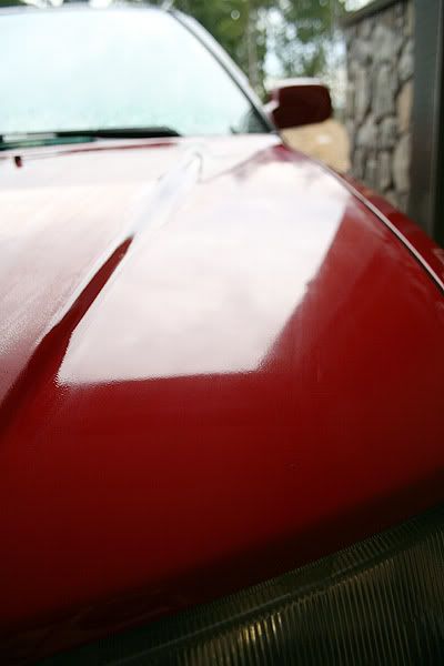

Looks decent from far away doesn't it

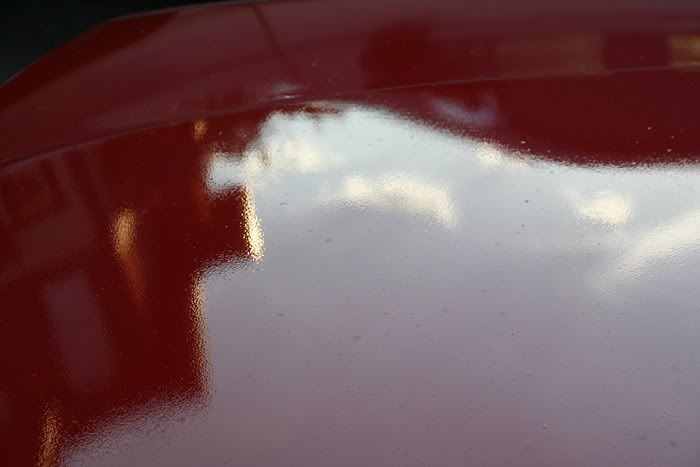

Not so much when you get closer

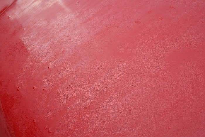

Sanded with 1000, 1500, and 2000 grit
Started compounding with HTXC via rotary x3-4. First experience with the LC CCS pads since I ordered them, and they seem to work pretty nicely.

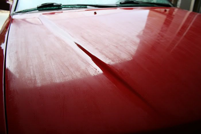

Now you can see the sanding marks still left...blurry blurry blurry
I don't know how much paint you actually put on but it is gonna be tought to get all that out without cutting through. I'd recommend on buying a quart of clear and putting 2 layers on, letting that dry, sanding with 1000 smooth and then putting 2 more layers on. After that you can wetsand and buff and it should be slick as glass. Single stage is much harder to spray and get to look right than bc/cc. On single stage you need to put wet on wet. It is tough because you usually get a run but that is the only way for it to flow correctly. Runs are easy to get out as long as it is a solid color in single stage or in a clearcoat. There isn't any single step that makes a paintjob stand out but the gun you use, how it is setup, and spray technique make a paintjob.

Yeah, my only problem is that some of the sanding marks are still staying even with HTEC on a cutting pad via rotary. Wool seems to be the way to go.
yeah that's the same problem i had detailing a car, HTEC didn't work for me, but HTHC w/ PC worked just fine. ::scratch head:: yeah i know what you're thinking. If you don't have that, step up to wool, that's about the only thing I'd do.
IMO I have had no luck with HTEC with wool. I like using Presta 1500 with the Presta/edge green or if needed the black wool to remove wetsanding marks.
