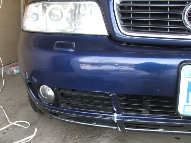

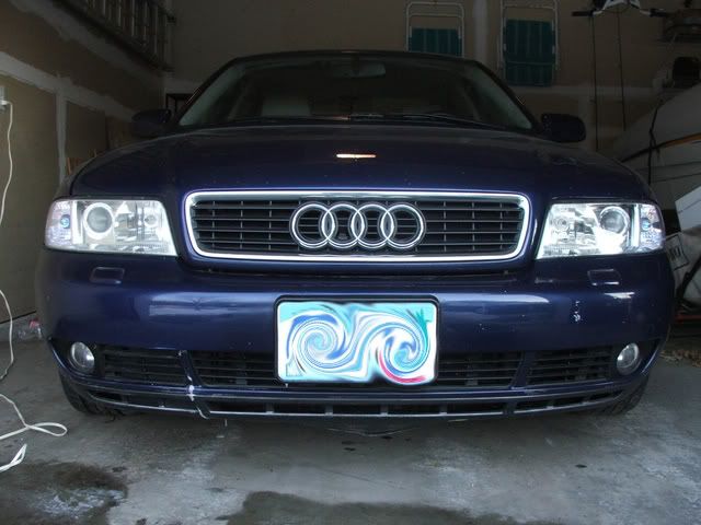

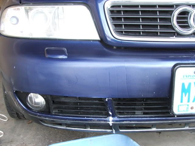

So a couple of years ago I ran into a road sign during a snow storm and it unfortunately left a gouge in my bumper. In november I got around to patching the gouge and I just now finished due to many, many mix ups/more like screw ups on Audi's end to get the right color paint. Thought I would post some pics of the process. I also have one question, the paint is a little textured and dull and I need to make it smooth to match the rest of the bumper. Now Im wondering what has to be done. I was thinking maybe like using a 3000 grit sand paper and then using some polish to shine it up. What do you guys recommend? I have a PC with some menzerna IP and some other things I ordered last summer.
Well here are the pics.

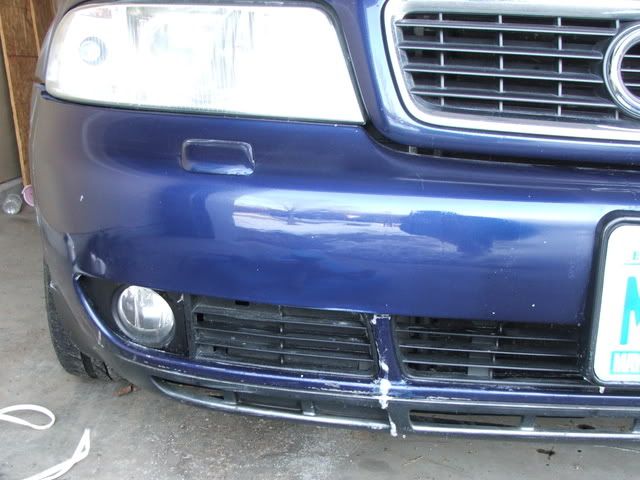

Before

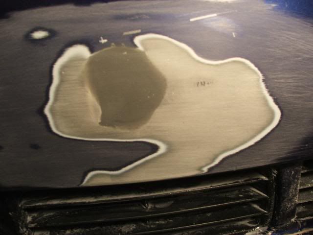

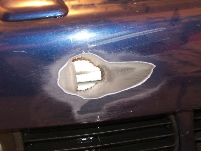

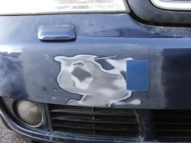

Sanded

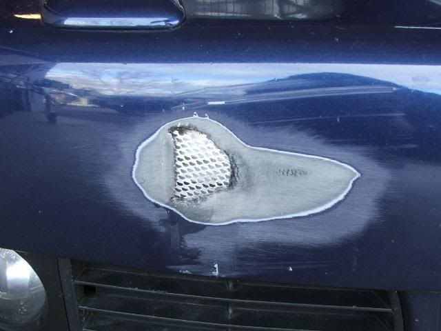

Backing Mesh

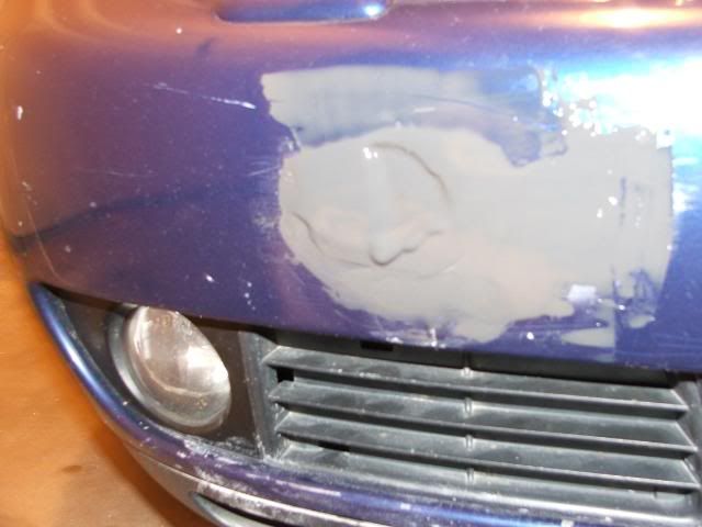

Filler Flexible SEM-Weld

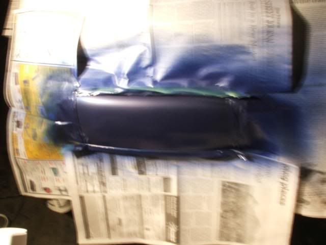

Paint Take 1
Not even close...

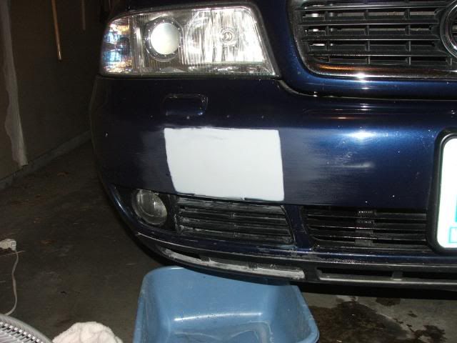

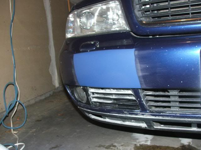

Take 2 (I didnt even want to paint the whole area because I knew it was going to be the wrong color again...)
Keep in mind that this is special order paint and takes 2 weeks to get there. I had to do this THREE TIMES! :hairpullYes I was pissed to say the least. Carousel Audi :wall. So we raised hell and finally got it sorted out.

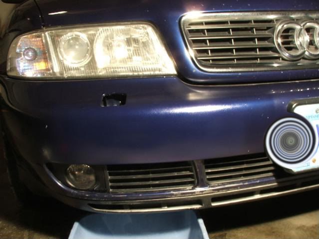

Paint Take 3
Close as its going to get.
Well there it is. I was pretty proud of myself this being my first experience with any bodywork what-so-ever. Again if you guys have any questions, comments and advice on how to get it to match better with polishing and such please reply.
Thanks guys!!

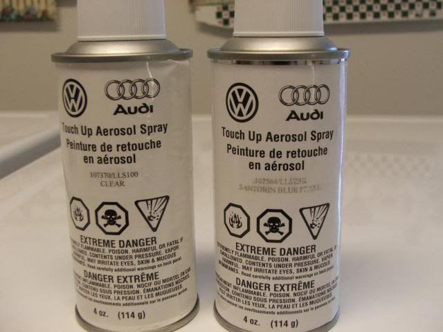

Well I'll be dipped. I never knew Audi sold Touch-Up paint in rattle cans.

Yeah i realize the color will be the same but I just want it to match the texture of the other paint being smooth not textured. The rattle cans are a pretty good deal, $25 for both color and clear.
Why wont it last? I used flexible filler because its a abs plastic bumper. How long do you guys think it will last?

That's on the paint side. I've never been a fan of those patches as a backing cause if the adhesive fails or starts to give water gets in there and causes the repair to fail. That's on the Body Work Side

I'm guessing the "texture" your talking about is just Orange Peel in the Clear. Read up on the Wetsanding I talked about before and give that a go. It's called "Cut and Buff" and a standard procedure for any paint job since almost every paint job will have some OP.

Was there any flex additive in the factory touch up spray cans? If there wasn't the repair most likely won't last long. first time someone bumps the car in the parking lot the paint will at a min. spider web or crack and flake off.

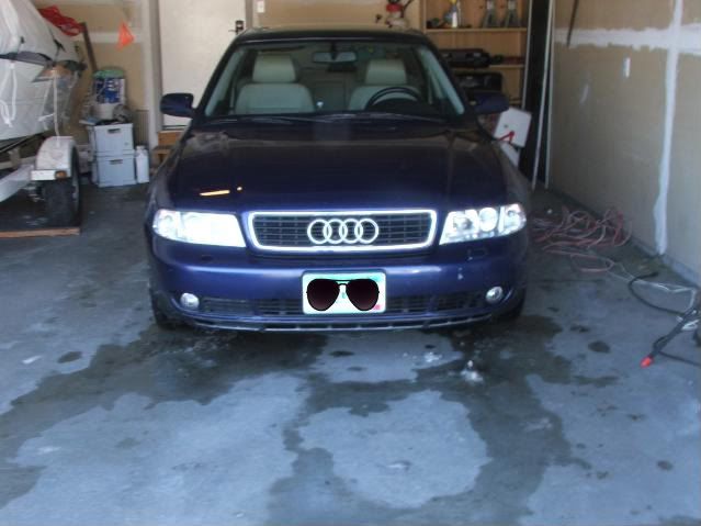

Well Im done and completely satisfied! :waxing:
I used 3M 2000 grit sandpaper.
And some Menzerna IP with a 4" green pad with the PC.
Now it looks better than the otherside! haha
Thanks for all your help MorBid!
Looks much better. It might be a good idea if you removed the plate frame so that you can remove the sanding marks near it. It looks a little flat in that area.
