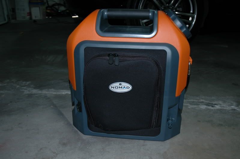

My take on Nomad with DI water:
It works, car came out spot free, except for my rims (had some water spots but they were removed easily). Probably needed more rinsing. My personal take on the Nomad is that its ok, not great. The proclaimed 90psi pressure will not blow you away but it is enough to properly rinse your vehicle. The psi seems to drop when I fill it up all the way then increases after about a min or two of rinsing, weird. I don't feel it saved me any time in drying because the output is not strong and it takes a while to fully rinse the car. Also, using 7 gallons of DI on my car to rinse did not help (I err on the cautionary side). The benefit I see is not inducing any marring/scratches. But if your a pro on drying with WW MF towels you are golden and don't need it.

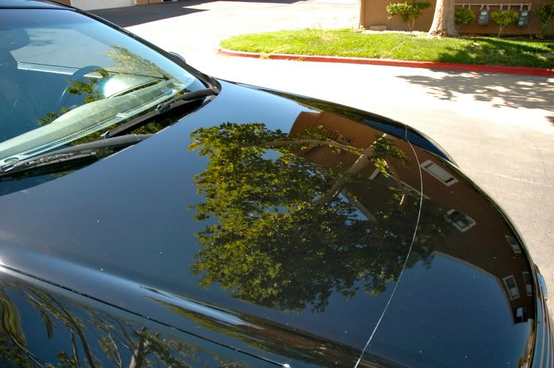

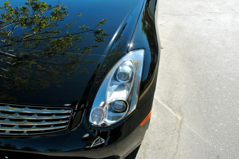

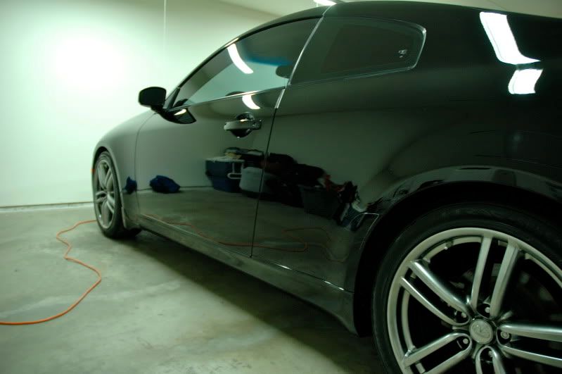

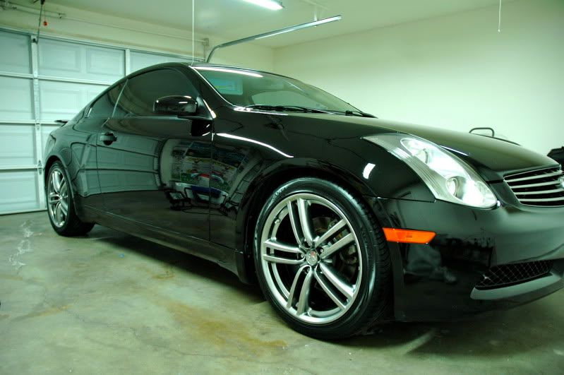

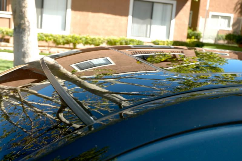

Ok, well enough talking here are the pics I kept promising...
