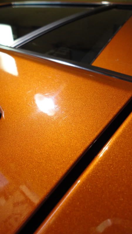

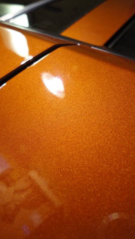

I will also try to get a few pictures of the paint of my car up close, but here are a few shots of the car as of right now:
Thank you in advance for helping me out, and for taking the time to read though that LONG post.
ok, these are the best shots of the hood that i can get at the moment, but it does show the light surface blemishes that im talking about:

The most serious problem you face is the roughness.
I suspect it could even be paint mist that could've come from your neighbours. Lots of my customers also hv these problems.
If it's indeed paint-mist,
1. Try using your claybar again, and clay repeatedly on a 1 square foot patch. Spend 5mins on this. Your previous claying could hv been insufficient or even wrongly done. If it doesn't work....
2. Dry the area. Lightly rub old MF cloth (moistened with acetone -nail polish remover) on the rough area. Acetone will damage your MF cloth. If you hv paint over-spray, the over-spray shd come off now. Absolutely safe on clearcoats. Don't worry.
3. If it doesn't help, get the stronger clay bars.
To get rid of this roughness (on your entire car) would take substantial time.
I'd suggest you remove the roughness first, before delving into buying machines and other products.
