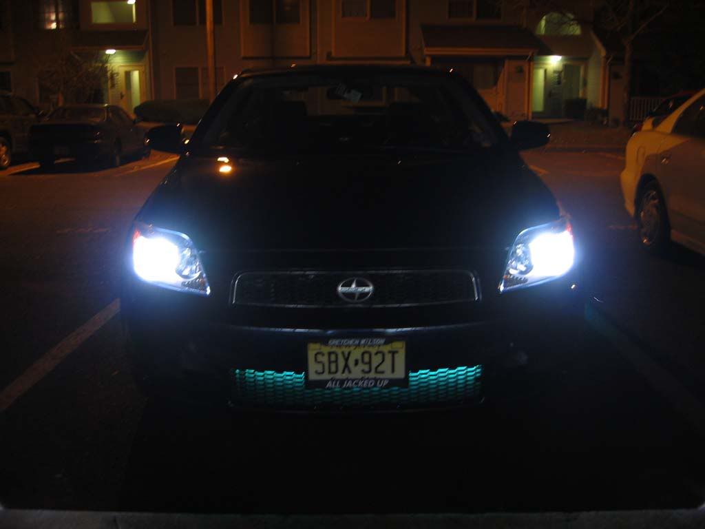

THIS IS THE TYPE OF LIGHTING YOU WILL GET.
THIS IS THE TYPE OF GLARE ONCOMOING DRIVERS WILL SEE AND FLASH YOU FOR

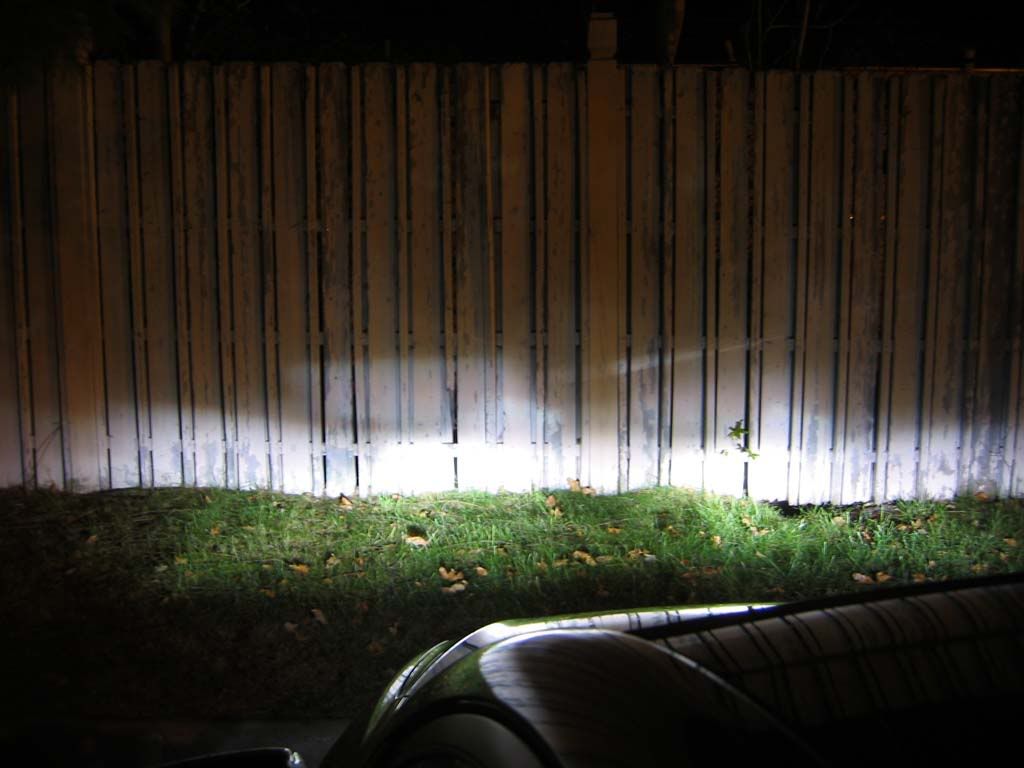

THIS IS ACTUALLY WHAT YOU WANT
THIS IS THE LEVEL AT WHAT THE LIGHT SHOULD BE AIMED SO THAT YOU DO NOT GLARE AND BLIND OTHERS.
If you plan on simply throwing in a kit then you might as well just install colors bulbs and drive with your highbeams on as throwing a kit onto a reflector housing will not be able to control the light output an HID sytem gives and distribute it uniformly.

Arrggghh, that Scion is from NJ :mad:
