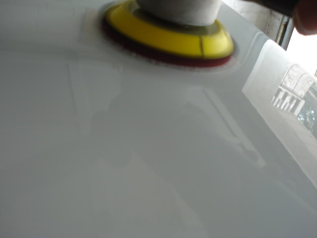

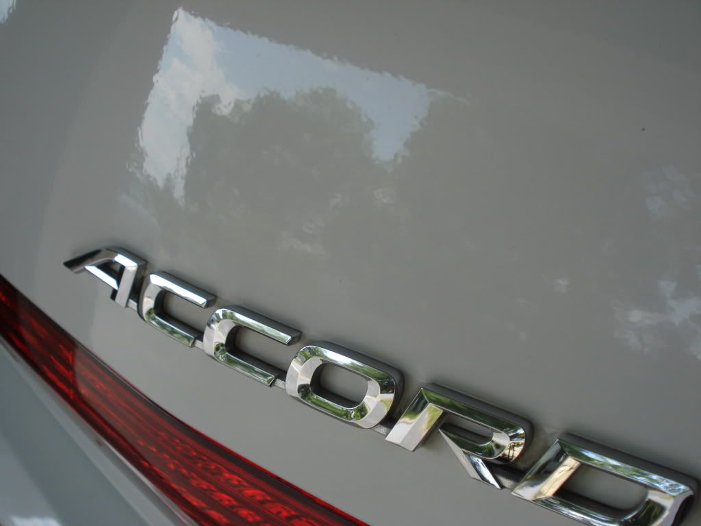

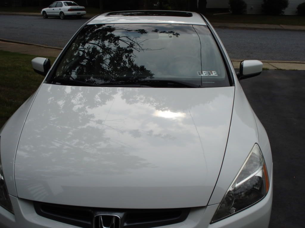

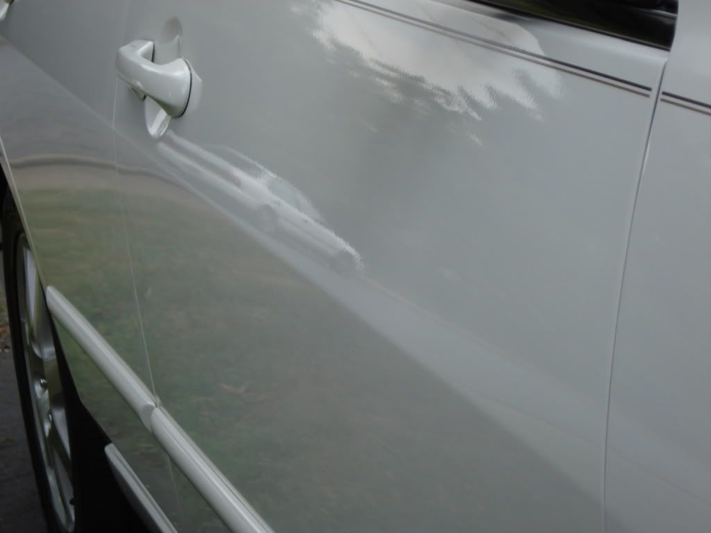

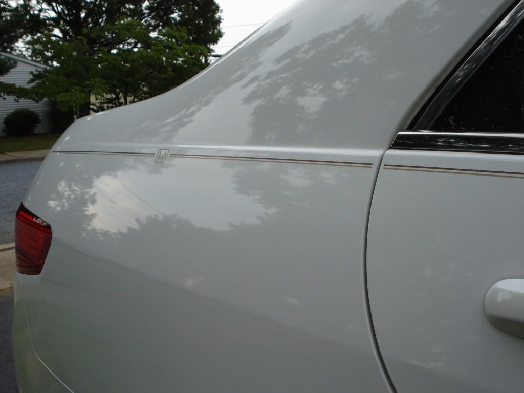

Hello Everyone,
Here is my process for cleaning my daily driver Accord. I am having a hard time posting a picture on here. I am new here and have been doing a lot of research and getting alot of great tips and help. I recently purchased M105 and was really scared about using after reading many posts on its cutting ability. I have to say this stuff was awesome and barley dusted at all for me. I cleaned it alot with compressed air. Please feel free to let me know your thoughts or suggetions. Below is my process:
ONR wash & Clay.
M105 on Meguiars 5" MF Cutting disk
HD Speed on a 5.5 White Polishing Pad
Armor All on tires
Opti Seal on Paint and Wheels

Sounds like a good starting point. Depending on the car, I would invest in a good polish also, for those times that you don't need the cutting ability of 105, and need more cut than Speed. What color is your Accord?
I definitely need a good Polish and after seeing what 105 can do I probably will go with 205. I also am considering Optimum Hyper Polish. Its White and hard to get nice reflections. This is the best I have gotten it. Pm me your email and I can send you some picks so you can see since I can't post images.
