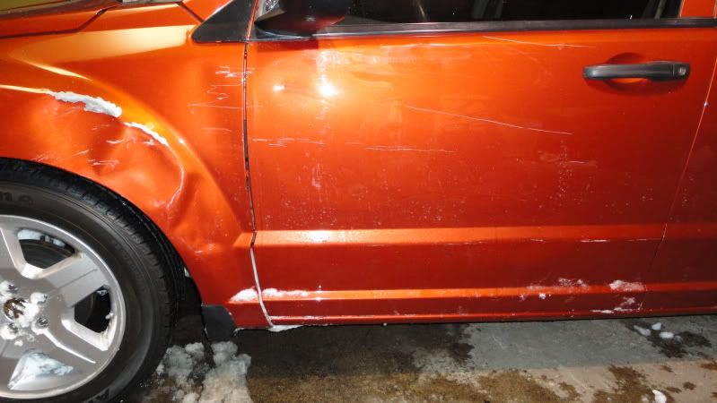

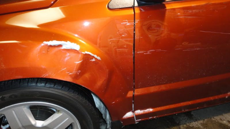

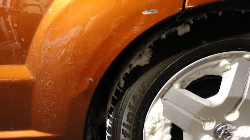

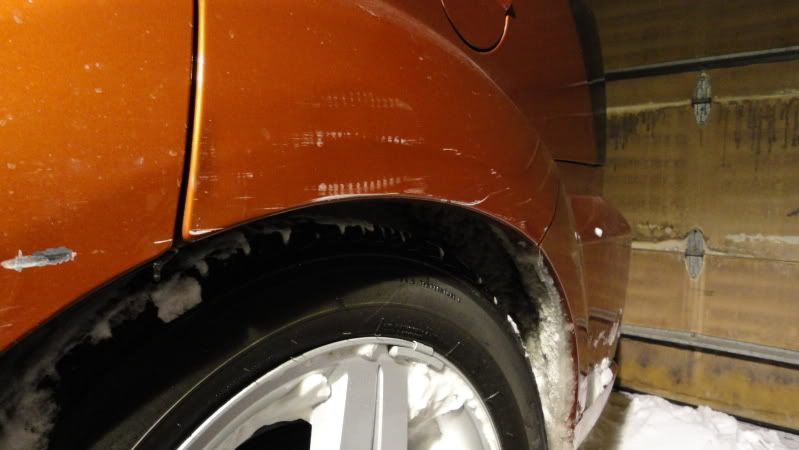

Oh, and here's pictures of the damage if anyone is interested. Ill be sure to post pictures up of the car once it comes back. Total damage was $3,300

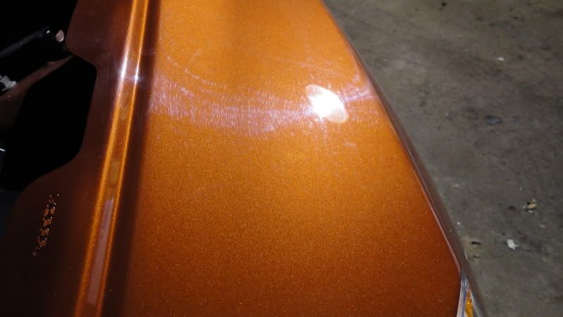

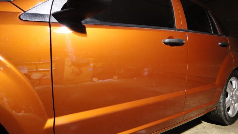

ok, here are two of the shots i took that show the swirling at its worst:
if you look at the picture of the fender, thats how the whole drivers side of the car is. BAD swirls..

While the paint is curing it'll often be a little softer than it'll be once the curing is complete. Once it *is* cured, it might be harder/softer/identical to your original paint, no real way to predict it (with luck, it'll be the same).
I'd *guess* that the UC you used before will work OK and that you won't need the M105/M205.
