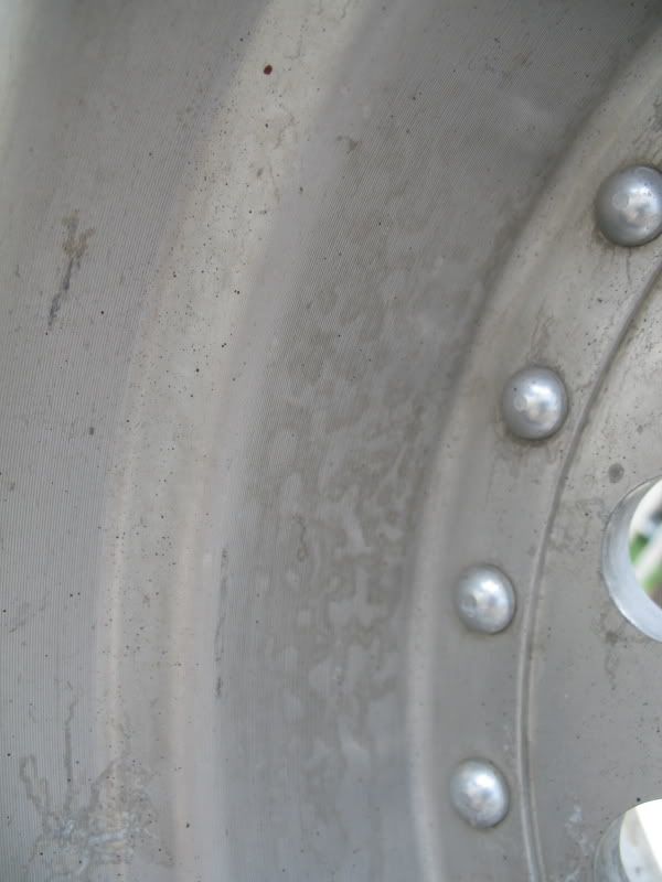

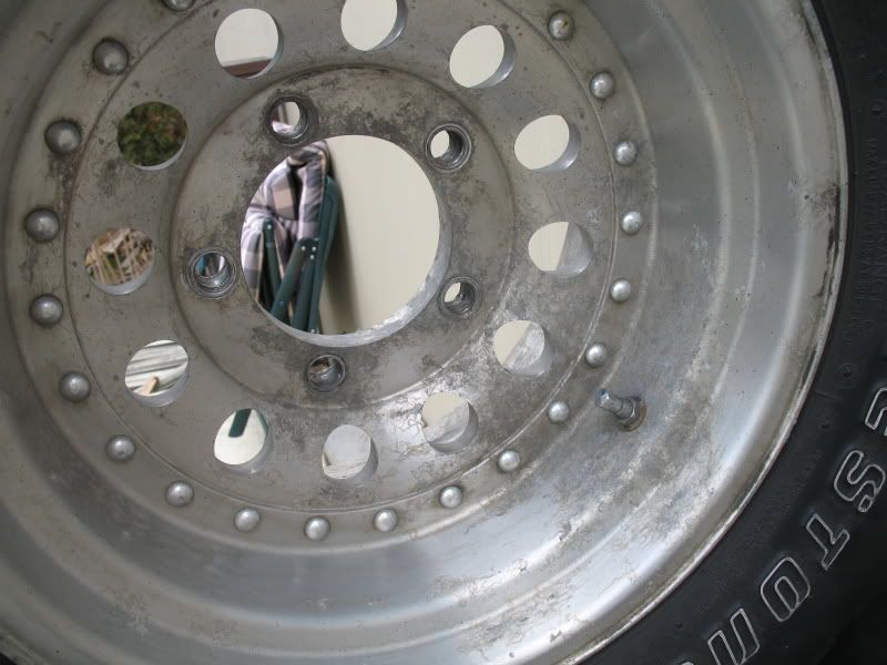

Best way to clean clearcoat off aluminum wheels?
Wondering, I have a set of wheels I need to take the clearcoat off... what is the best route?
I don't really want to sand them if I don't have to, the finish is FINE underneath, just needs to be bare and polished
Thanks for any help! I wanna spend the least time possible on these...

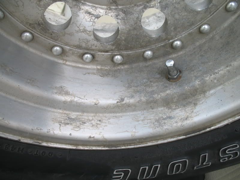

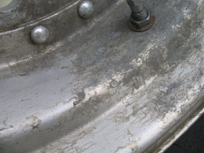

Good luck with that Stumpy, IMO that finish isn't "fine", it's corroded around the valve stem, and it's going to look just as bad after you get what little clear is left in that area off.
StumpyDetailing said:
Yes, but I would much rather sand and polish the areas that need it instead of ALL of it!
there is a machined finish on the Aluminum
so ALL of it will need to be sanded & polished:sadwavey:
