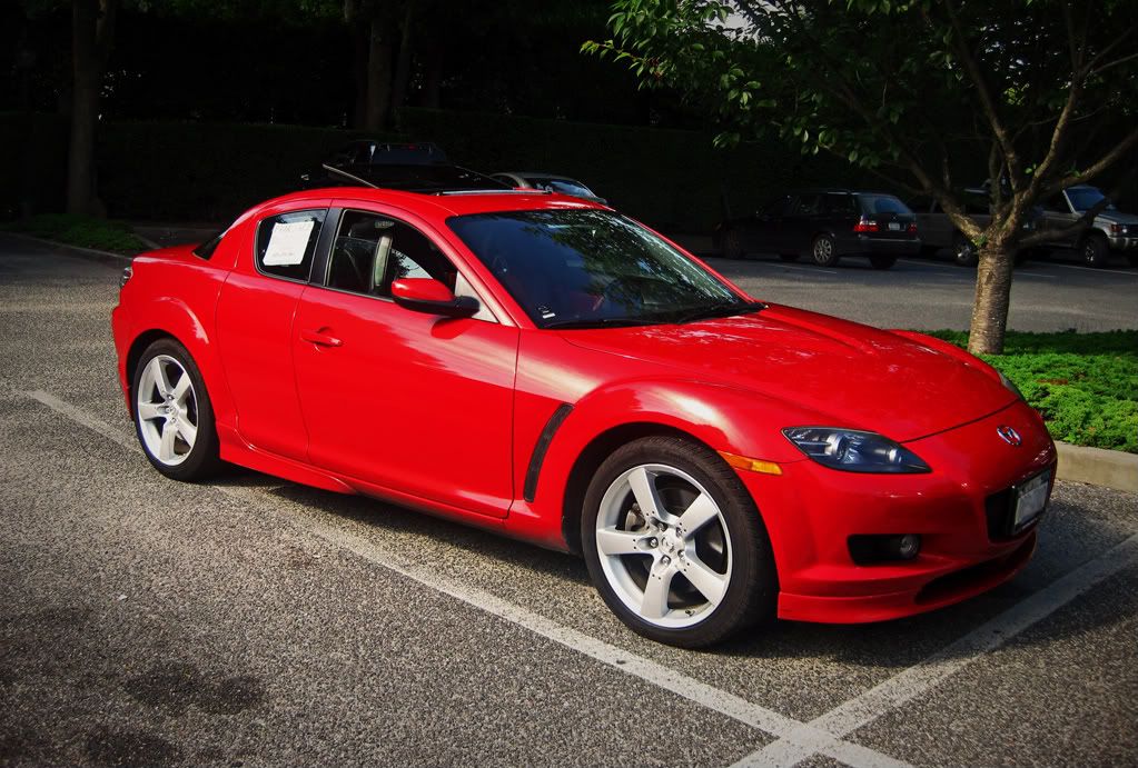

another qx4 - I have a 2005 RX-8 in VRM. When you get it wash and clay it first. If you need to polish it Men. PO85RD or 3M ultra fina is my choice. Then a glaze like Red moose glaze is optional. Wax I like Souveran. Good luck PM me if you need to ask me about more questions. My RX-8 looks as good as if it rolled off the showroom floor.
Here it is. There are some swirls and bird crap etchings, but other than that, it is absolutely mint.
