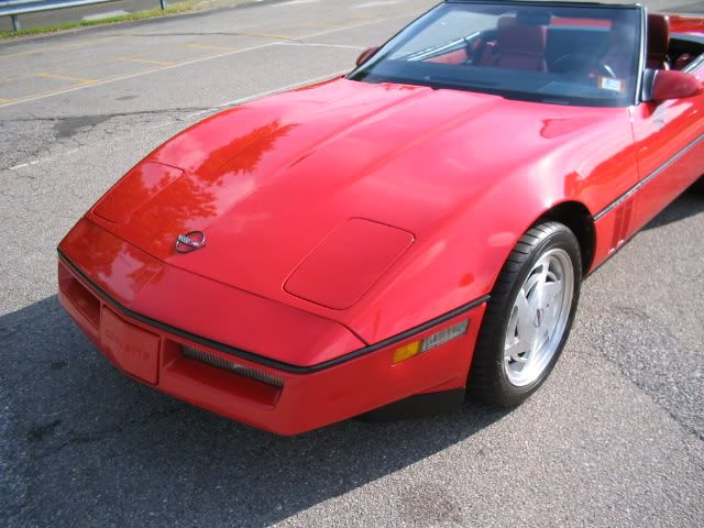

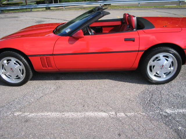

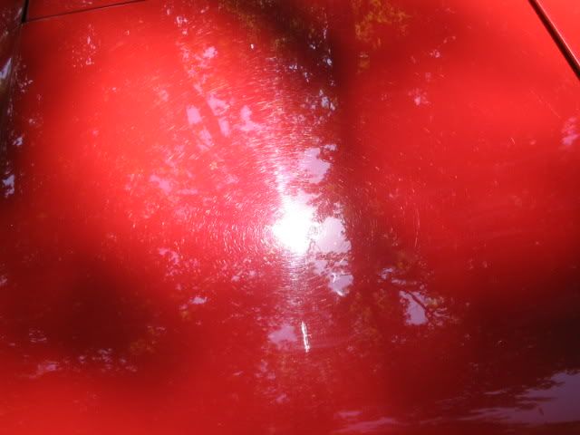

Here is my Dad’s Torch Red ’89 ‘Vette convertible. Prior to the detail it suffered from cobweb scratches which made the paint seem not as bright as it should be.
All in all, minus the interior, which I had detailed only a few weeks back, and the closer engine detailing, I estimate the detail took me about 7 to 8 hours, the long rear deck and hood of the ‘Vette deceived me, taking more time than I thought.

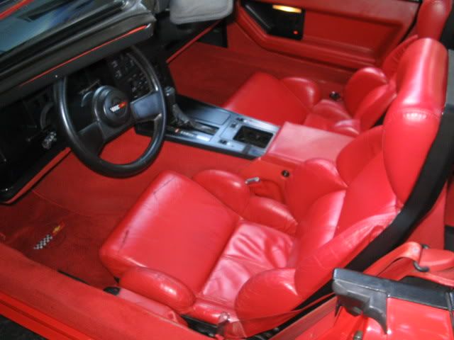

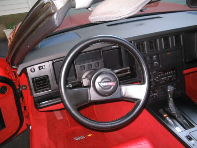

Interior:
Vacuumed via typical Shop Vac
Two spots on mats were removed with Meguiars APC+
Seats were cleaned with 6:1 water:Woolite mix
Seats conditioned with Lexol
303 on vinyl panels/trim and weather stripping
Klasse AIO/SG on hard plastic console parts
Novus #1 sprayed on cluster display

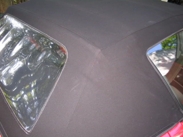

Convertible top:
Remaining lint removed with a large Evercare lint roller on extension handle
This roof is fragile. There’s a bit of acid rain pitting in the plastic window
Novus #2 applied with a cotton terry cloth brightened it a bit. Followed with spraying Novus #1. I did not want to experiment with #3 due to the weak window

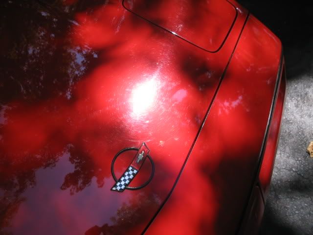

Polishing via Cyclo: Nothing exotic, used two “classics�: DACP and PI III MG
DACP #83 and yellow Lake Country cutting pads
3m PI III MG and white Lake Country polishing pads
alcohol wipe after every panel

The car has permanent acid rain etching and it still has several scratches that are “the next level deeper� to cobwebs. I did not experiment with more aggressive polishes ( let alone rotary)on them because a few years back the entire car was wet sanded in attempt to reduce the acid rain damage. Because the thickness of the paint is unknown now on this 15 year old car, I played it safe and focused on enhancing gloss instead of striving to make the car 100% defect free.
In short, the car has never looked look better!

The leather seats, the driver's in particular are wrinkled. The driver's side is severely, the leather has cracked and in one spot is being reinforced by glue! :eek: I doubt any of the Leatherique products can make an ample improvement
