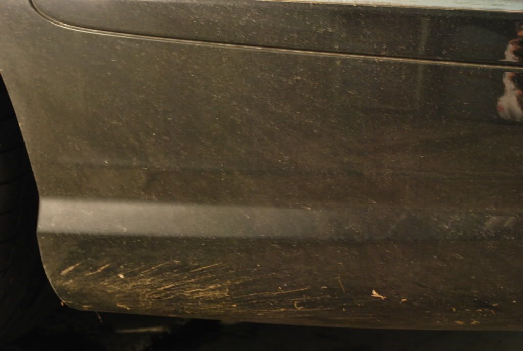

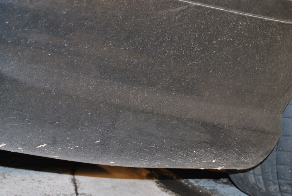

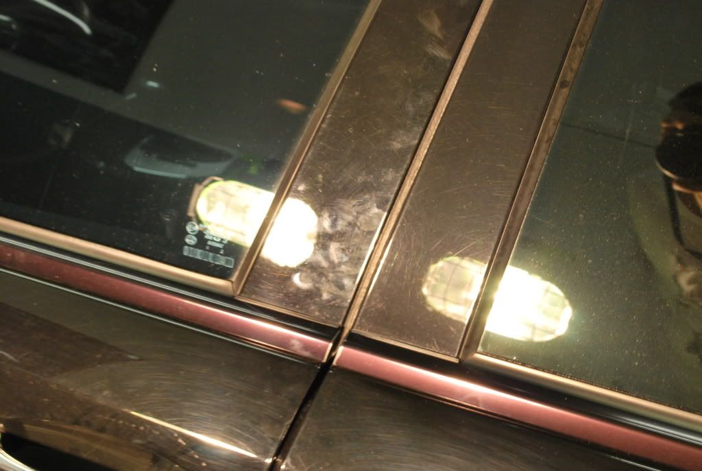

The owner has an extremely busy schedule and lives a great distance away, so he has been having a local detailer perform regular hand washes in between visits. Unfortunately, this person did not do a very good job washing the car since I had last detailed it, so the paint was in horrible condition.

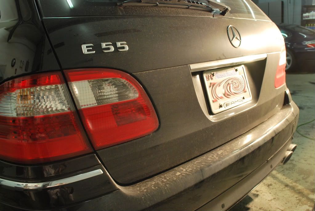

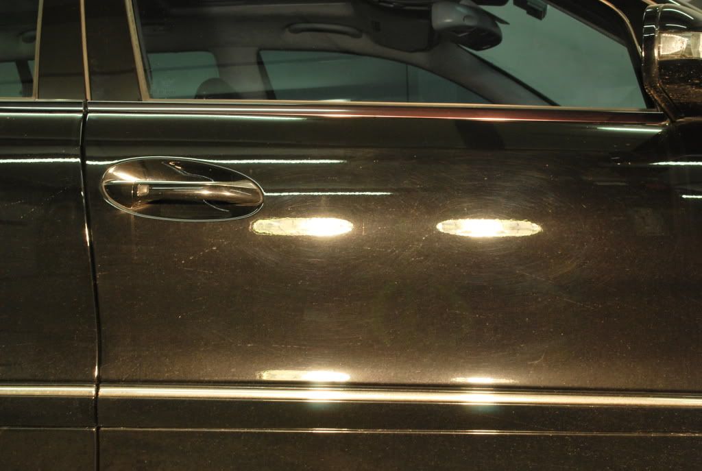

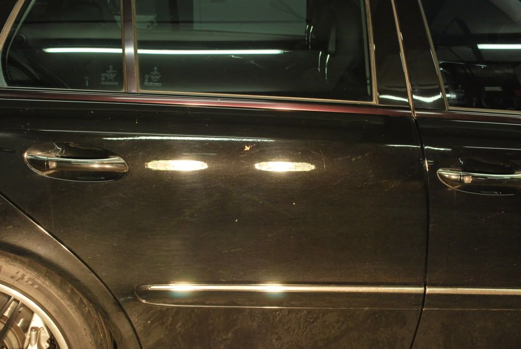

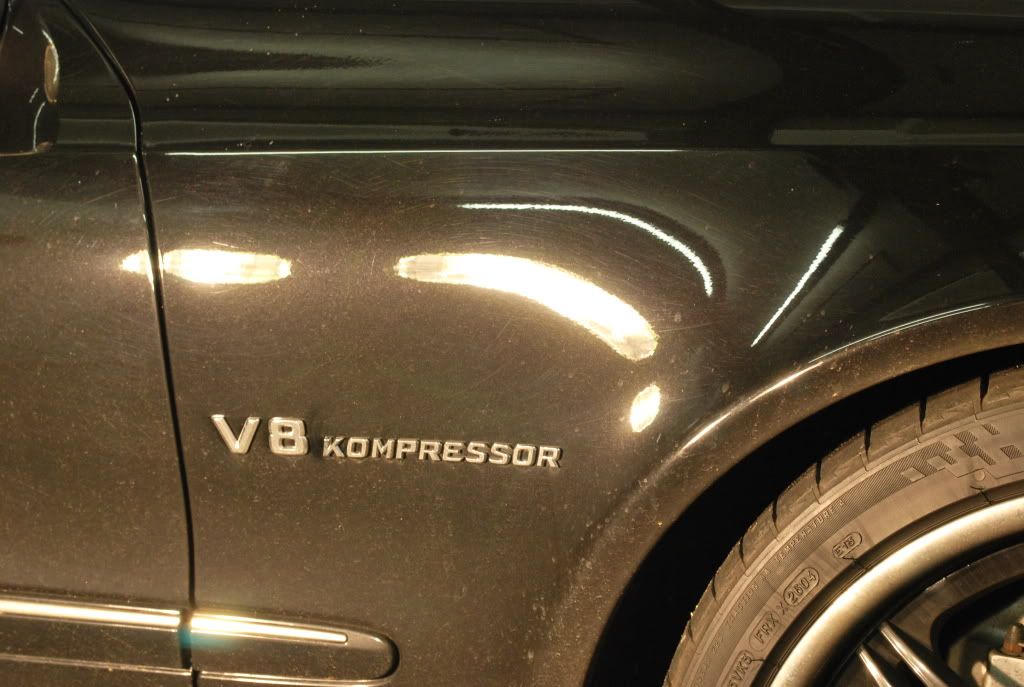

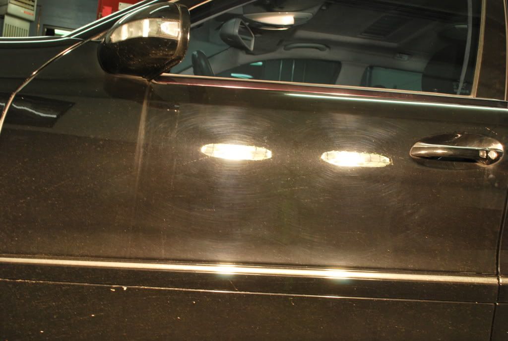

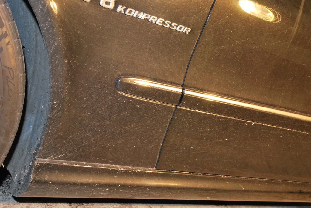

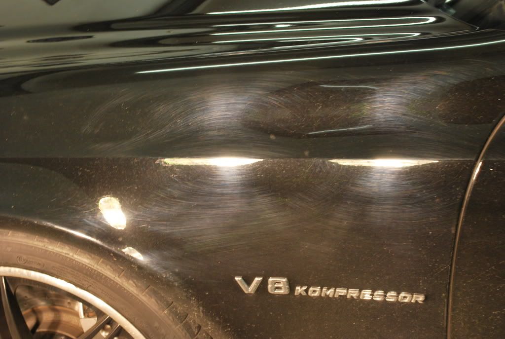

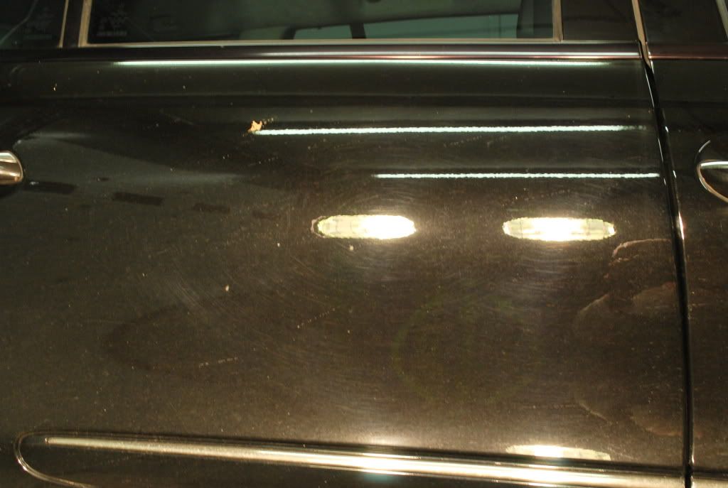

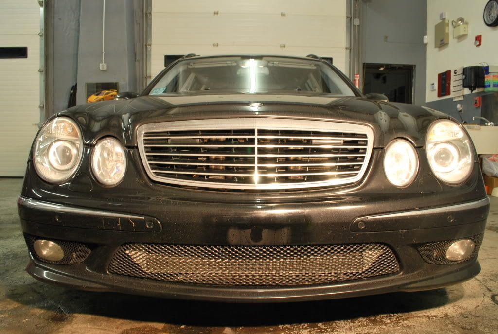

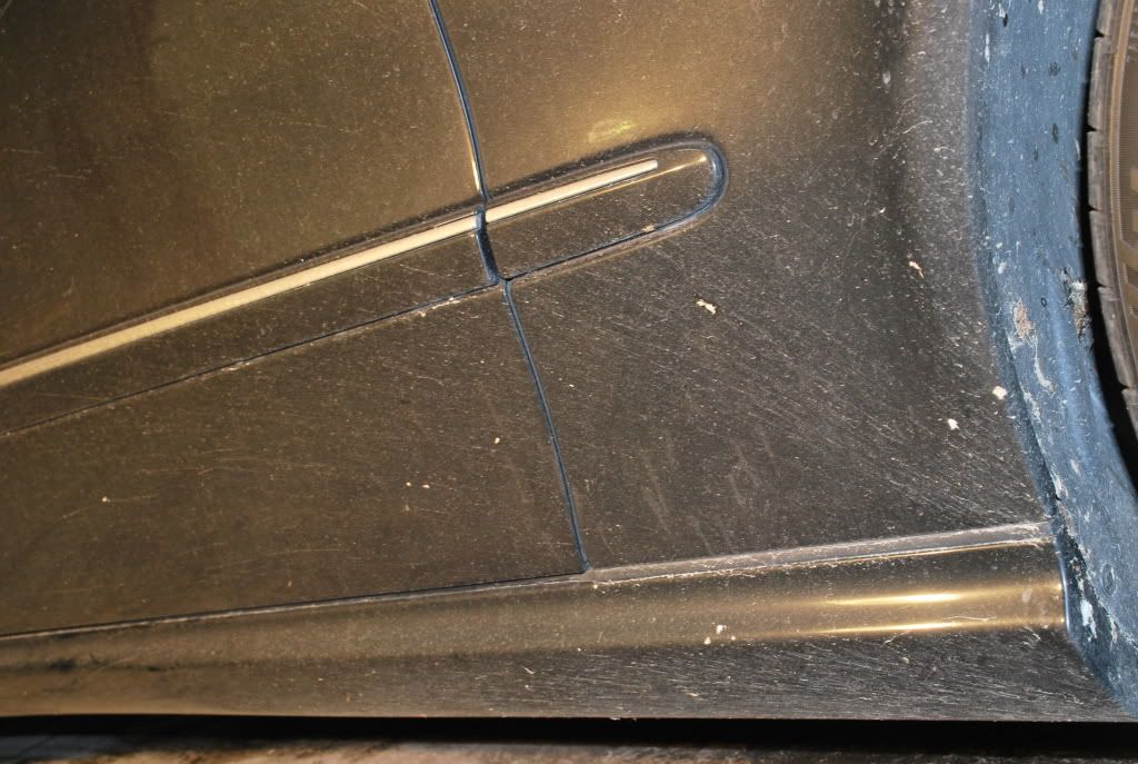

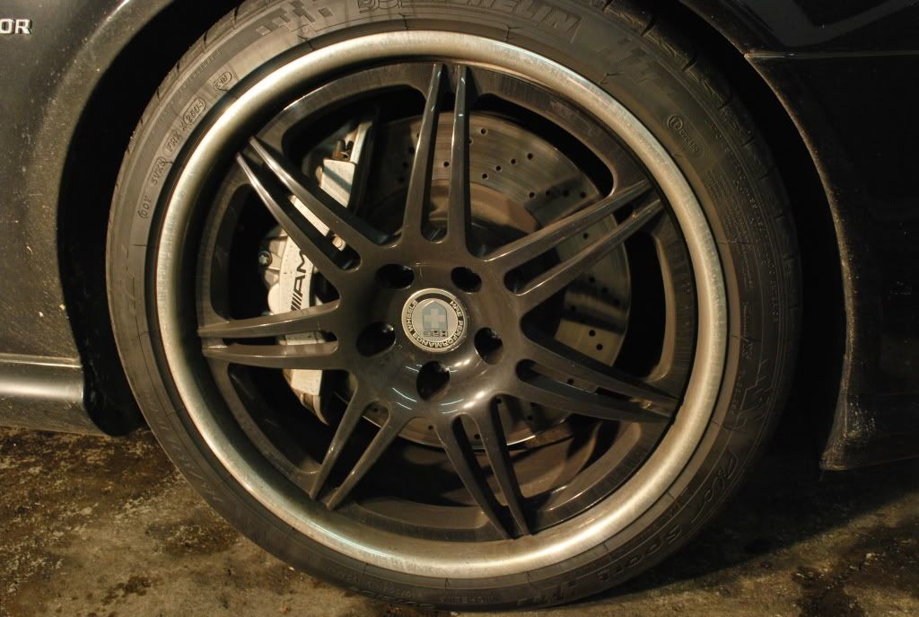

Below is what the car looked like upon arrival…
Exterior…
Interior…

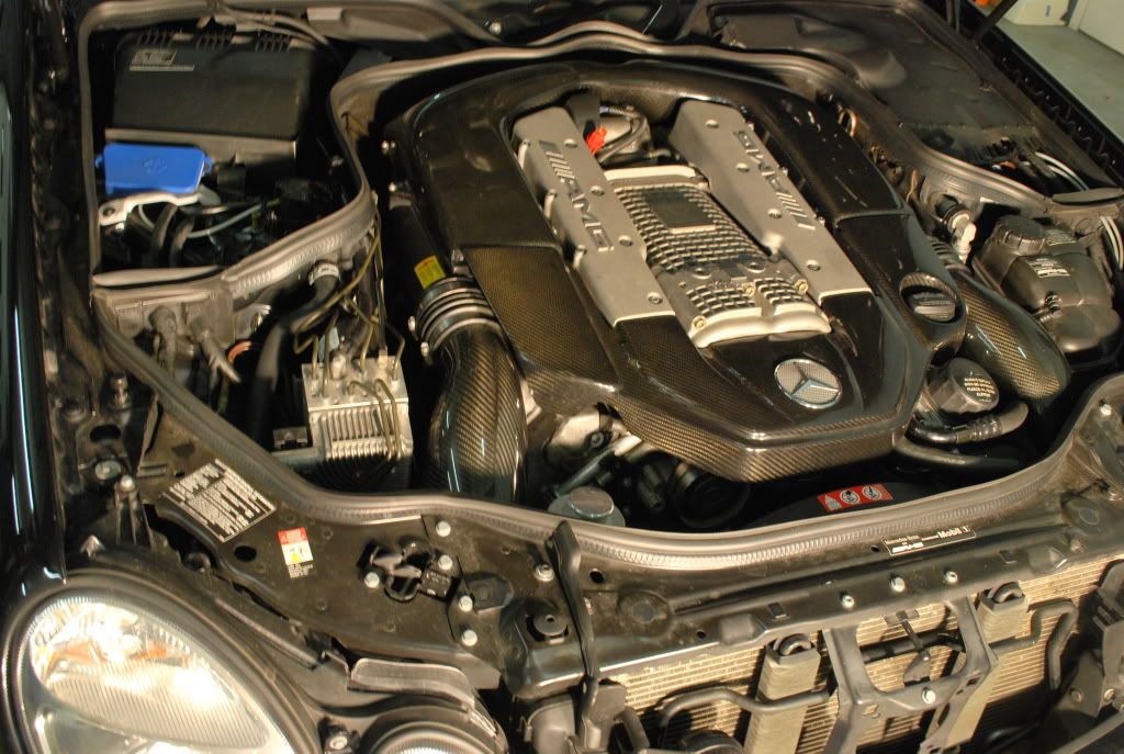

Engine compartment…
As you can see, the car was in dire need of a proper detail. Before any paint correction could be undertaken, I began by giving the car a thorough wash and extensive cleaning of all wheels, tires & wheel wells, followed by a claybar treatment and engine compartment detail. All previous wax / polish was stripped using a degreaser and rinsed. Once the vehicle was dry , I wiped down the complete exterior with 91% alcohol. It took me about 3 1/2 hours in total to prep the car for polishing.

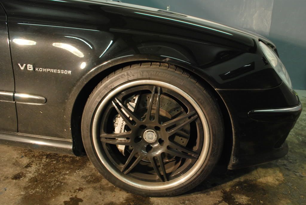

Below is what the car looked like after the wash …

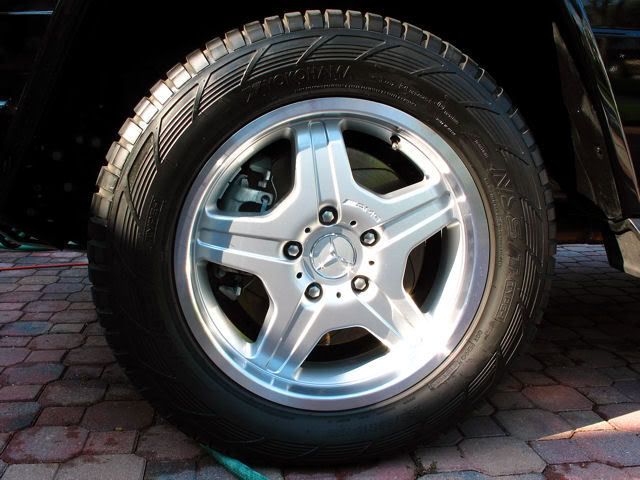

Before applying the LSP, I spent about an hour polishing and sealing each wheel using a variety of products, then polished the chrome tips and dressed all tires & wheel wells.

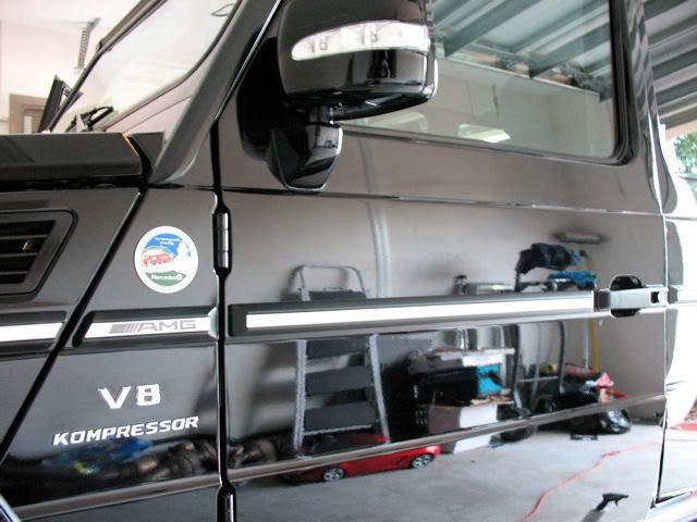

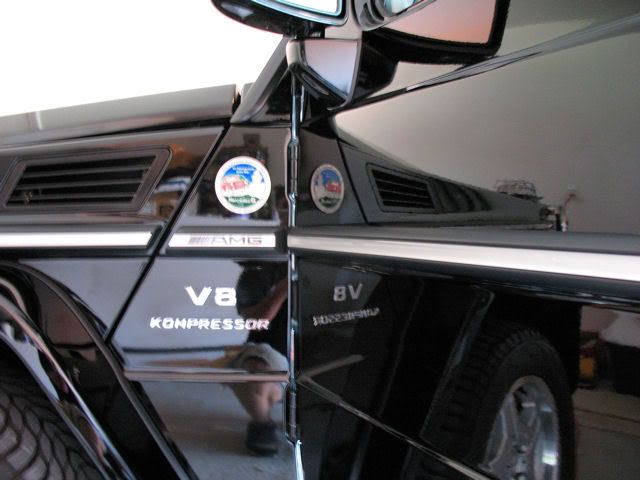

For protection, I applied 2 coats of Opti-Seal, roughly 4 hours apart and left the car inside over night to properly cure. The following day, I applied a coat of Carnauba Moose Wax by hand, which really added to the look. I then wiped down the complete exterior with a quick spritz of OCW (version II) to remove any residue that might have been remaining and treated all exterior glass and chrome with Opti-Seal.
The car will be driven through the winter and will probably need another extensive detail in the spring, but at least it is clean for now…
Here are the final results…
